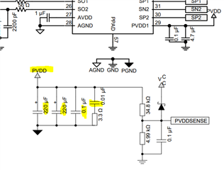

Currently in design / prototype we have 48 brushed motor design (with ability to go to 3 phase brushless ) We are seeing the same failure at 24v and at 48v. One of the failures is when we demand the motor to work then stop (energy still in system abrupt stop to go the other way ) The DRV8302 fails - the 5v stays up but it fails in such a way if i replace the chip its taken the PCB with it (6 layer , things are tight ). I do have a feeling I have a layout problem maybe some tracks need to be floods as I've looked at the design guide. The design guide shows for a 2 layer board , as I've said mine is 6 layer with a GND plain. We have also seen the track from 2.2uF caps to pin 29 blow (this could have been due to operator connecting a 48v inverter up to the board incorrectly) i am happy to post up Altium schematic and screen shots of layers / gerbers

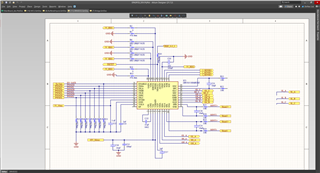

  • Hi John,
    Please see the below suggestions and questions in response to your e2e post:
    Questions:
    1. what is your expected motor phase current during regular operation? and peak current expected under high load?
    2. Other than the situation described above where the motor is demanded to stop (brake/stall condition), does the motor system run fine normally?
    3. Fault condition
      1. does nFAULT (pin6) pull low during this situation?
    Suggestions:
    1. Bulk capacitance (page 24 of the datasheet, section 9.1 titled 'Bulk Capacitance')
      1. on the schematic provided, I am only seeing two 2.2uF caps and one 100nF cap for the PVDD1 pin.
      2. Situations like the forced brake/stop you mentioned will result in the motor pulling a lot of current from the 48V PVDD bus, cause it to change from 48V.
        1. In this case, you need bulk caps in the system to provide this immediate current or else the 48V will drop and cause problems
        2. these missing caps might explain why your 2.2uF caps blowing during motor brake
      3. In the datasheet page 21, section 8.2 for 'Typical Application' diagram - there are two 220uF caps which are for 'bulk' capacitance.

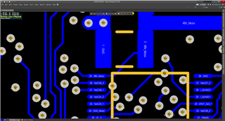

    2. Layout
      1. It's hard to tell from the Altium layout screenshot alone, but the capacitors related to the DRV8302 device need to be placed as close as possible to the IC's pins. This typically includes caps such as: (between CP1 and CP2), for DVDD, for BOOST, and for PVDD1/PVDD2 bypass and bulk caps - to name a few.
      2. also, gate drive traces (for signals like GHx, SHx, GLx) need to be ~15-20 mils thick so that the motor commutation signals don't have excessive noise/transients.
    3. Attached the two links below that may be helpful to your system design, especially for layout.
    Documentation:
    Thanks and Best Regards,
    Andrew

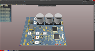

  • the 3 caps are 1000uf each ..
    the top two studs are 48v + top and 48v gnd underneath it ... on an inner layer the 48v joins to the stud in the middle of the board , the next screen shot is the board flipped in altium showing the drv chip

    After reading the links you have posted up on here i do think i have a lay out problem - i was a bit rushed as we needed something for the software guys to use ...
    The project is done under altium. If you have access to Altium and would like a look at the PCB layout , i'm fairly sure i can let you have a copy or even if we discuss it over "teams " with screen share.  I have been thrown in at the deep end with this. I did lay most of the board out (just not the drive stage ) but we used the chip in a previous project but at 12v with no grief and i did didn't even think we'd have problems " as we've used it before with no problem".

    • on the schematic provided:
      • I am seeing a lot of connections for the 4 hardware interface pins, but am not sure what is populated
        • you should be using only one setting at a time, meaning that one of these resistors has to be removed in your system.
        • the resistor you choose to disconnect will depend on what you want to do (see screenshot below, or datasheet page32)
      • here's an example: for the DRV device's MODE pin, it can choose between Independent, 1xPWM, 3xPWM, 6xPWM modes
        • if you want 6xPWM mode, you need to tie the MODE pin to AGND. (4th row on page32 tables for STATE/RESISTANCE/MODE/GAIN)
          • this means you need to replace R5 with a 0-Ohm resistor, so that it's a direct short to GND
          • you will also need to completely remove R4 in this case, so that the device doesn't get connected to '5V_REG' which I suppose is DVDD.
        • if you want Independent PWM mode, you will need to tie the MODE pin to DVDD directly
          • this would mean keeping a 0-Ohm resistor on R4 to connect MODE to 5V_VREG/DVDD
          • you will also need to completely remove R5 in this case, so that there's no connection of the MODE pin to GND through any resistance
      • the example above applies for the other HW interface features as well
        • your GAIN can be 5/10/20/40 V/V for the current shunt amplifiers
          • this is for the motor phase current monitoring -> see the math equation in section '13.3.4.1 Bidirectional Current Sense Operation.' If you are using the wrong combination of gain, Rsense, and Vref -> this could trigger a Vsense overcurrent fault (SEN_OCP) & pull the nFAULT pin low, disabling the device because it thinks your motor phase has too much current
        •  IDRIVE setting controls how fast you switch the MOSFET gates on.
          • Too much causes ringing at switch nodes, too little results in inability to drive the MOSFETs (or very slow turn-on)
        • Vds is another protection for overcurrent.
          • It's basically calculating how much current is flowing across the MOSFET, based on your MOSFET Rdson and the voltage drop between drain/source nodes (V=I*R).
          • If your Vds setting is too low, then it will trip overcurrent even though not that much current is flowing through the MOSFETs
          • your resistor settings on Vds, depending on which one you populate, will have Vds threshold at either 0.7V or 0.2V (is this ok for your MOSFET Rdson and expected motor current?)
    HW interface configuration resistors (MODE, GAIN, IDRIVE, VDS)
    Datasheet page32, shows info on how the HW interface pins (MODE, GAIN, IDRIVE, VDS) are set up and what bias settings correspond to what device behavior:
    Andrew
  • Please be aware , I have mentioned this before. I am using a "brushed " motor , this is NOT connected to a 3-phase motor. I am using 2 of the half bridges..
    The hardware interface connections are only one at a time .. the schematic was just so I could get some 'pads' down ..
    The motor is currently not connected - i'm not going to connect anything until i see the 'bridge ' right.
    currently i have my R5 is 0ohm/shorted for 6 PWM (i have tried all modes) , R9 is 0ohm /shorted - disable vds ,  R12 is shorted - lowest setting as not calculated .

    I can see on layout is that i'm using a ground plane not ground flood and on your example layout the thermal pad is connected to your flood.. but as the chip wont come out of fault i cant tell if its going to over heat - the board is a dev item so if this needs addressing it can be done.
