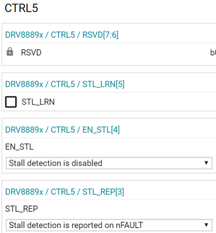

  •   Hello
    The logic of locked rotor detection function of motor is as follows:
    a、Initialize ctrl5 register, STL_Rep = 0 reports stall error through register; EN_STL = 1 enable stall detection function;
    b、Ctrl3 register microstep_ Mode is set to: full_STEP_WITH_100_CURRENT;
    c、Ctrl1 register TRQ_DAC is set to current_100_PERSENTS
    d. Set CTRL2 register decaly to 0x07 and toff to 1, that is, smart_TUNE_RIPPLE_CONTROL.this data I have check again form read CRTL2 register,DECAY is 0x07;
    e、STALL_TH torque is assigned to ctrl6 register, now it is set to 25.
    f.  Read fault_STL bit of status register
    g. If STL is set, it indicates locked rotor and Ctrl4 register CLR_ FLT setting: clear stall setting at this time, and then judge whether it is in locked rotor state again.
    For the above register configuration, I read the configuration data of the register during operation. The read and write data are consistent. Sometimes I can read STL is 1 and TRQ_COUNT  value also is ZERO for many times. Please help analyze what's wrong. Thank you.
    The follow picture STATUS bit 0 is 1,because Stepper now is not run,So I have set CRTL2 bit DIS_OUT is 1,and at this config Stepper is not give out heat。

  • Rain,
    Several reasons could cause the stall detection function issue.
    1. When you enable the stall function, please set SRL_LRN=0 to disable the learning function. In learn mode, DRV8889 won't report the stall condition.
    2. According to https://www.ti.com/lit/an/slvaei3/slvaei3.pdf equation 5 and 6, a higher coil resistance (>10ohm) could cause a high IxR error to the TQR_COUNT.
    3. To reduce or cancel the ixR error, the coil current 1st quadrant and 2nd quadrant waveform should be symmetric. Please check the output current to make sure the output current follows the ideal sinusoidal waveform.
