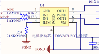

Because of the supply problem, I consider replacing DRV8871 with DRV8870 in mass production. Discarding the IChip feature is acceptable. I wonder if it's theoretically feasible?
Hi, Wang Li,
Thanks for your reply.
How about making the DRV8870 pin 4 floating? Will the pin 4 voltage be higher than 0.3V stably?
Drv8872 looks better than drv8870 to replace drv8871, have you any concern in this usage?
Hello, Xiaodong,
We can not allow DRV8870's pin 4 floating.
Yes. DRV8872 is more better to replace DRV8871. I don't have any concern. Also, the following link gives the comparison:
