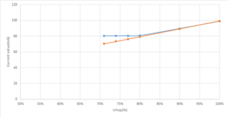

We are now testing the current regulation function of DRV8842 on the evaluation board.
The test evaluation is below;
Target : DRV8842EVM
Rsense : 5.1ohm
Vref : 2.5v
Moter(TM) : L=43mH, R=24.9ohm
VM : 24v
We would like to check current regulation with adjustable Ichop.
IN1 and IN2 is constant. IN1 is 14%, IN2 is 0%.
In this case, Ichop is adjusted between 0% to 100%, and expected current value is 100mA.
Results of each test case is as a following;
In these results, Act current and expected current is disagree when Ichop is lower than 80%.
We would like to operate current regulation when Ichop is between 0% to 100%.
Could you please tell me about configuration of correctly operated current regulation?

  • Hi Kobori-san,
    I am happy to help, no worries about the late reply. After reviewing your data I think I might have found the issue. The reason that IChop is not being able to regulate current below 80% is that the target current is too low for the device.
    This is due to blanking time, here is the section of it on the datasheet:
    8.3.4 Blanking Time
    After the current is enabled in an H-bridge, the voltage on the ISEN pin is ignored for a fixed period of time before enabling the current sense circuitry. This blanking time is fixed at 3.75 μs. Note that the blanking time also sets the minimum on-time of the PWM.
    Essentially lowest current that the device can achieve via current regulation is limited by the blanking time, once the current is re-enabled by the rising edge of the input PWM signal it needs to stay on for a fixed 3.75uus regardless of what the current is. This is why on the images you presented you can see how the pulse width gets shorter from case 1 to case 2, but past case 3 it stays consistent. It can no longer become any shorter and therefore can't reduce the current any further.
    If you would like to read more I went into more detail in your other E2E post:
    https://e2e.ti.com/support/motor-drivers-group/motor-drivers/f/motor-drivers-forum/1052825/drv8842evm-regarding-current-regulation
    The solutions to achieve a lower current during current regulations are the same because they stem from the same problem of having too low of a current threshold Itrip for current regulation:
    • If you haven’t already try changing the device’s decay mode to fast decay. This can be done to setting the decay pin to logic high, and should help increase the current decay.
    • If possible lower the input voltage so that current will rise slower through the windings.
    Please let me know if you saw an improvement with the suggested fix or if you have any other questions.
