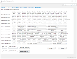

I have tried to check the fault condition by using the InstaSPIN_F2806xM_UNIVERSAL from GUI COmposer, DRV8305 SPI. The same problem gets repeated here, when I enable the system, there is no fault, but as soon as I run the motor the fault appears. I have attached the screenshot below.

    I see the AVDD_UVLO bit is also set, is AVDD votlage sufficient? Have you checked the full scale current setting used by the firmware before running the .out file in the directory in the application GUI? The SNS_A_OCP bit is likely a software overcurrent issue because an incorrect FULL_SCALE current value is set in user.h.

  • I have not changed the default values, I have just updated the user.h for the motor settings as specified by the excel sheet provided in Motorware.
    I don't know the cause of AVDD_UVLO to be set.
    These readings are from a brand new DRV8305EVM.

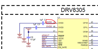

  • Hi Prabhat,
    I do not know the hardware setup of the LAUNCHXL-F28069M with BOOSTXL-DRV8305, please keep the default configurations of the LAUNCHXL-F28069M and follow any instructions in the BOOSTXL-DRV8305 User's Guide. Does the AVDD_UVLO bit ever clear with a clear fault command (setting CLR_FLT)? Are you ensuring the WAKE and EN_GATE bits are high (device is in operating state) and the device has no faults before doing any MotorWARE initializations?
    AVDD on the schematic of the BOOSTXL-DRV8305 has no current load since nothing else is implementing AVDD. Also what voltage and current are you operating your motor at? We can double check these calculations are correct in implementing InstaSPIN-FOC.
    Also forwarding to Yanming Luo for InstaSPIN-FOC support.
    Aaron

    I am surprised to see AVDD_UVLO be set since in the EVM schematic, AVDD does not connect to anything.

  • I am attaching the corresponding register values for the BOOSTXL-DRV8305 and my custom-DRV8305 board. I have included all the files for boards connected with motor and without motor nad have used lab01b.out and lab2a.out.
    In all the cases, the voltage rating shown in GUI is correct and no-fault when I press enable. Errors occur instantly when I press run.
