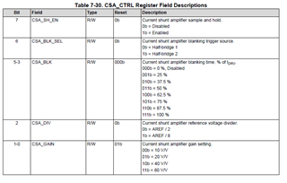

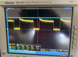

I am using a DRV8706 to drive a brushed DC motor controlled by an MSP430F5529. I have a 2mR shunt  between SP and SN and am monitoring the  SO pin with an ADC input. I have tried various configurations of the CSA register, but the amplitude on SO remains the same no matter what the load current is through the shunt. The noise obviously increases if I adjust the gain from 10V/V to 80V/V. Please see a scope trace of the SO output - I am pulsing the bridge at 7.782kHz.
From the datasheet, I understood that the SO output would be proportional to the current measured between SP & SN.

    -AREF pin requires external supply (e.g 3V). It is supply for Shunt amp block.
    -IC_CTRL (addr 0x04) LOCK bit. If 110b, registers are locked.
    -Better to "CLR_FLT" is DRV has some fault condition.

    1. AREF is attached to 3V3 (VDD_M1) as per the reference schematic for the EVM.
    2. IC_CTRL is not locked
    3. I clear CLR_FLT before writing to the CSA register

    1. The R112/R110 divider does drop the voltage, but this does not explain why the voltage doesn't change amplitude with different load currents. The output remains the same amplitude whether I am driving an average current of 1A or 5A. I will try remove R110 to see if this helps, but I don't believe it will.
    2. R120 I will try a larger resistor, but this does not make sense either. The voltage between SP & SN increases when I increase the load current from 1A to 5A, but the output at So remains the same.
    3. I have tried various values for CSA_BLK, but this does not make any difference to SO. I have left the blanking at 000
