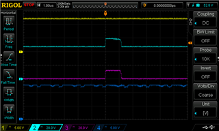

  • Hi Andrew,
    We have done those tests. Screenshots below:
    channel 1: VCM
    channel 2: CPH
    channel 3: CPL
    channel 4: VGLS
    Below is just powered up, no motor spinning.

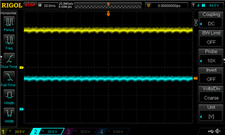

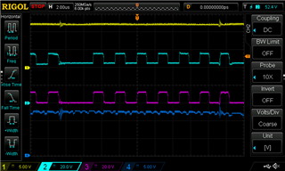

    Motor spinning - about 27A Iq
    Motor Spinning - about 30.1A Iq

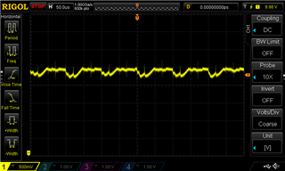

    We then tested with the VCP and VDRAIN
    channel 1: VCP
    channel 2: VDRAIN
    Zooming in on VDRAIN
    13.7A Iq
    20A Iq
    30A Iq
    Clearly there is a more significant voltage drop at 30A than 13A (1.5V vs 1V). But there is also a lower peak voltage on the 30A test (51.5V vs 54V) - battery voltage is 46V for this test. Is this expected, and would it likely cause the error if the Iq was increased to 47A?

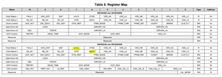

    In the meantime, can you help confirm if the below two bits in the register map are the flagged UVLO and GDUV fault flags you're seeing?
    • Just want to make sure we're looking into the right fault conditions for the debug
    Thanks and Best Regards,
    Andrew
  • Hi Andrew,
    Yes, those are the two that show up, and always together
    Oliver

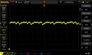

  • Hi Andrew,
    I have managed to run the test with a differential probe across VCP and VDRAIN. Screenshots below:
    Test 1: 21.6A Iq
    Test 2: 27.3A Iq
    Test 3 - 30.1A Iq
    There's not much difference between the three from what I can see, (maybe a slightly increased frequency of the transient spikes). And variation is within 0.5V of 10V.

  • Hi Oliver,
    Thanks very much for sharing that waveform -
    If I'm interpreting that correctly, the waveform for VCP-VDRAIN is hovering around 10V reliably on your bench
    • this is safely above the Vdrain+5V typical undervoltage threshold seen in the datasheet, which is good
      • at least this is true in the controlled lab/bench environment data, where we are not seeing a GDUV/UVLO fault
    • still not sure what other variables there might be different between lab environment vs on-the-road environment
      • do you have any other suggestions for ways to replicate the GDUV/UVLO faults in the lab setup?
