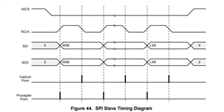

When reading a value from a status register on DRV8343-Q1's SPI, which timing does a valid data come from the SDO?

SDO data is propagated on SCLK rising edges and should be captured on SCLK falling edges.
Ensure SPI clock phase and clock polarity is 0 to read SDO outputs correctly. If you have questions please follow this E2E FAQ on SPI configuration and use: e2e.ti.com/.../faq-spi-configuration-and-use

I've created a picture to explain the question. Is it correct?

Yes this info is correct. Please reference section 8.5 Programming in the datasheet.
