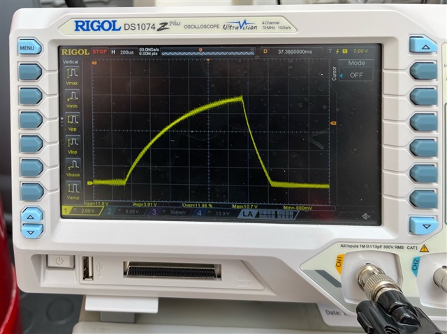

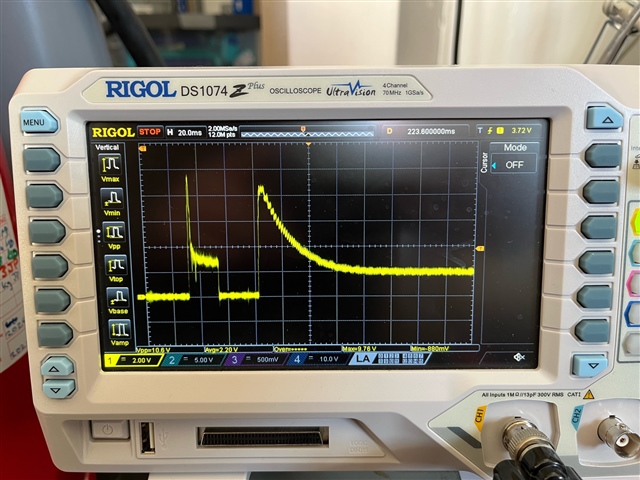

  • Hi Ryan,
    Here is the photo of the current going to the motor (1V=1A) when an external current limiting is put on the source supply:
    Here without the external current limiting:
    Closeup of it:

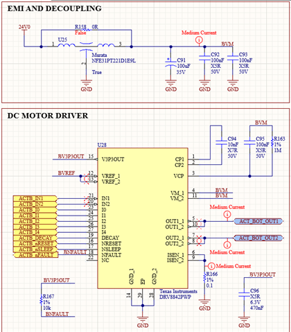

    And here is the schematic of the driver:
    We have two motors with the same configuration, but one the I0-I4 is set to 100% of Ichop and the other to 50% (Ichop = 4.3A), neither of them works...

  • Camila,
    Is it possible to add another channel to your scope and capture nFAULT pin response?  Would also be good to capture current level when nFAULT occurs.  It looks like the driver is hitting OCP which can occur if the current is ramping too quickly.  Is there any capacitance on your motor?

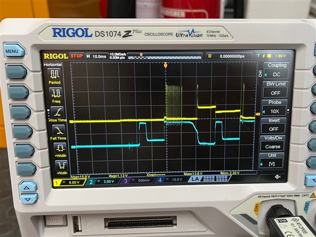

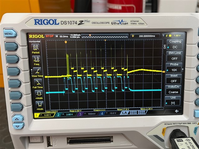

  • Hi Ryan,
    Yellow is the voltage on Out 1 and Blue the voltage on nFAULTY (both in relation to gnd):
    Do you know why is zero even before the sparks?
    When the motor is working (with the external current limiting) the nFAULTY is 3.3V as expected.
    Camila
  • Camila,
    That is very bizarre behavior on nFAULT.  Do you have an external 10k pull-up resistor soemwhere on the schematic to 3.3V?  You mentioned the nFAULT is latched low before:
    When I connect the motor the nFAULT pin goes low but the nSLEEP stays high, I would need to disconnect it and press reset for the nFAULT to go back to high.
    But that is not what I am seeing in your scope capture.  nFAULT is an open-drain output, so should pull hard to GND for a fault and release to 3.3V thru the pull-up resistor when everything is normal.
    Ryan
  • Hi Ryan,
    I only have the R167 10k ohm going from nFAULT to 3.3V (output of pin 15) as it shows on the schematic.
