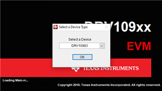

    5. When opening the GUI, is the DRV10987 option selected in the drop down? How can I see that?

    Did you select DRV10983 when you open the GUI?

    Yes, I always select the DRV10983. I find another problem when connecting the DRV 10983 to 24V. The voltage falls to 3.4V. I think the controller may be broken.
