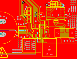

I'm using a DRV8300DI (Inverted) gate driver IC and at the moment I have some trouble with the current measurement (Low-Side Measurement).
I already have an article here and I changed from the INA286 to the INA240, but still have trouble: https://e2e.ti.com/support/amplifiers-group/amplifiers/f/amplifiers-forum/1103739/noise-in-current-measurement
So I'm thinking, that it has nothing to do with the CSA, but something to do with how I switch the MOSFETs.
Problem:

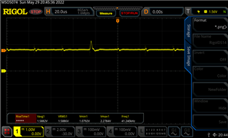

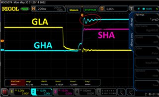

I see strong pulses on the CSA output from the INA240, where the pulses got stronger when I increased the gate resistor from 10Ohm to 39Ohm:
What I noticed when I increased the resistor to 39Ohm is, that the MOSFETs get warm (35°C) without any load and I have 3000mm2 for cooling.

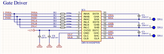

Schematics:

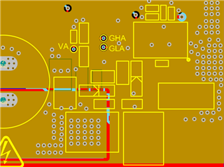

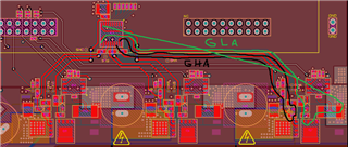

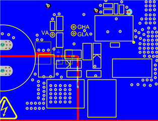

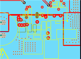

Layout:
TOP
GND
PWR
BOT
Output with 10Ohm gate resistor and 200Ohm output resistor (SHA) to GND:

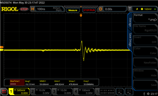

Output with 39Ohm gate resistor and 200Ohm output resistor to GND:
Edit:
I made some more measurements today and I don't really think I have a shot through, but probably the Cds capacitance is coupling into the shunt, where the shunt has a non negligibale inductance and that leads to a glitch. The following measurement is with a spring probe over the low side shunt of 300uOhm, so that is probably the noise, that the CSA is reacting to. It is a really fast input, so I will try to use an input filter in the next design anyway. The noise comes probably from the inductance of the shunt and when the low-side switches, Coss is shorted to GND and this probably is the reaction from it.
Is it really possible, that the INA240 (and also the INA286) react with such a step response to a such fast transient?
Edit 2:
When I add an input filter to the amplifier, I can drastically reduce the glitches, so I think this really fast transients activate a step response, that is way way slower. With a better filter I think I can handle them, but my question ist now, how fast pulses on the input still lead to such a step response? Does any dirac puls give me the step response stated in the datasheet? So probably for low side shunts it would be beneficial to use a very fast differential amplifier with >10MHz bandwidth and an input filter. Since the low side fet will always shunt the Cds, there will always be a spike over the shunt and especially for low shunts and high CSA amplification, there will be less damping and this leads then to more noise on the output. I will probably go for in-phase current measurement with the INA240, but I'm unsure if this might also give problems with the 100V/V amplifier and 300uOhm shunt or do you think, the INA240 can handle this better?

    For some of your gate drive signals specifically,
    • this could be a measurement error as you mentioned (e.g. parasitic inductance and capacitance on the probes themselves or other parts of the PCB)
    • it could also be considered 'Ringing' from your MOSFET switching speeds (e.g. slamming the MOSFETs ON/OFF too quickly w/ high slew rate)
    Please let us know if this resolves your questions. Thanks!
    Thanks and Best Regards,
    Andrew
  • Hi Andrew,
    Thanks for your answer. The noise coincides with the PWM frequency and seem to have to do with the shunt inductance, since I can measure this waveform from above over the shunt itself. I doupt it is coupling into the probe itself, since I measured with the spring probe and when I measure from GND to the shunt low-side, I can see how the HF noise decreases as it reaches the HF path to the vias.
    You are probably right, that the turn on is too steep. I already tried out 39 Ohm gate resistors which gave me around 100ns turn on time, but this also lead to shot-through, since the Cgd was strong enough to push GLx into a high state for several ns. Probably a anti parallel path with a schottky diode for faster turn off will stop this.
    How do you define the turn on time? Is it for SHx to reach 90% of it's final value?
    Here is also an interesting discussion about the INA240, it is probably not the best fit for low side current measurement: e2e.ti.com/.../ina240-high-freq-dv-dt-transients

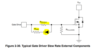

    Your suggestion for preventing shoot-through by having stronger SINK current than SOURCE current is exactly what we recommend from a system design perspective. The smart gate drive app note goes into this as well, but the components are just comprised of resistors and diodes as mentioned.
