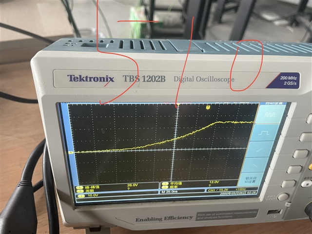

       Thanks for your reply.I am not sure weather there is a negative trainsient.I only use this for preventive effect .So it makes me puzzled that how this  TVS destroy the mosfet?Make it switch faster or slower?
      You say we need add a gate resistor. Do you see my schematic diagram? I have add a 510Ω and our rise time is 250 ns.Do you means if I add there is no negative transients ,the TVS is not necessary for my pcb?  I add the waveform before I add the TVS.

    Based on the waveform provided I do not see a negative transient, therefore I do not think you need a protection against negative transients. You can add a unidirectional TVS diode between GLx and SPx rated between 15-18V for suppressing positive transients.

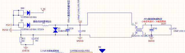

    I would like to know whether the different grounds you have (DGND, SPGND etc.) are connected with each other using a net tie or a 0 Ohm resistor. If they are not, I recommend connecting them and seeing if the issue persists. This would help diagnose the issue.
    Also, I would like to make a correction to the previous reply. If you decide to add a unidirectional TVS diode, then it has to be between GLx and ground.
    Akshay
  • Hi Akhay:
          I send the picture about the DGND and SPGND(PGND).There is a common mode choke between  PGND and DGND. But reference ground of these drive chip like drv  ,mosfet is SPGND.And some sample signal ,we use DGND.So you can see  the SCH I send before,I add
    the two-way TVS between GLX and SPGND(PGND).

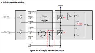

    I have discussed the issue with my team and we noted that the bidirectional TVS diode will not help with suppressing negative transients. You want the diode to conduct if there is a negative transient. GLx will have to dip to -15V transient for the diode (an unlikely event) to conduct with a bidirectional TVS diode.
    We recommend implementing a diode in the following manner:
