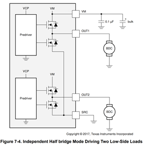

Hi Team, seeking some clarifications.
1. Can DRV8873 control a step motor as DRV8833 (see below block diagram)? Or equivalently is it 2 legs (pair with upper and down MOSFET, see below block diagram) or 4 legs like DRV8833?
DRV8833 (4 x 4 = 16 heaters per board)
DRV8873 (4 x 2 = 8 heaters per board)
2. If 4 legs, can DRV8873 (pin 14, 15, 18 and 19) be controlled for each leg like DRV8833?  From the Table 7-23, it looks like being able control each leg respectively
3. Look like both mode EN/IN1 and PH/IN2 as well as mode PWM can apply PWM signals up to 100KHz but how about the independent mode, what type of control signal will be?
4. If question 2 can control each of four outputs individually, how to control each one output with only two control pins as EN/IN1 and PH/IN2?  Or control 4 outputs individually through SPI port?
