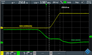

    Could you provide a waveform of VDRAIN, GHx, SHX, and nFAULT? Wave forms are captured before DRV 8323 damage below.

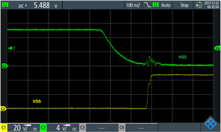

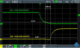

    Turn on—Low-Side MOSFET  VGS and VDS
    Turnoff—Low-Side MOSFET   VGS and VDS

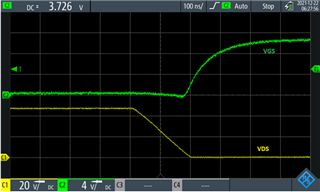

    Turnon—High-Side MOSFET   VGS and VDS
    Turnoff—High-Side MOSFET   VGS and VDS
    Dead time

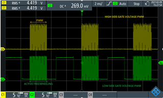

    PWM signal for high side and low side MOSFET

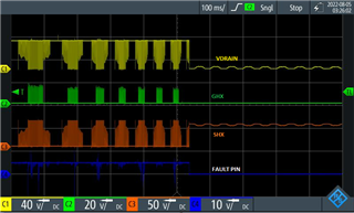

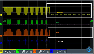

    Could you provide a waveform of VDRAIN, GHx, SHX, and nFAULT? waveforms captured for damaged DRV8323 while rotating 2or 3 revolutions below and please let us know if any further details required.

  • Hey Balabhaskar,
    This device has a maximum operational voltage of 60V and 48V is very high so the layout must be very well designed in order to mitigate the effect of parasitics.
    Are you using the VDS OCP? If so what is your trip setting?
    It is very possible that the Idrive setting used is very high. Would it be possible to reduce the IDrive setting to see if it helps with the issue? VDS might be coupling into the low side and lower Idrive might help with this.

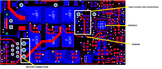

    Could you share your layout and schematic in order to help assess the design?

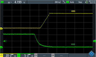

    It is very possible that the Idrive setting used is very high. Would it be possible to reduce the IDrive setting to see if it helps with the issue? VDS might be coupling into the low side and lower Idrive might help with this. Ok will try this but current Idrive is 120mA source and 240mA sink, and rise time and fall time we are getting below
    Highside Turn ON             :-300ns
    Highside Turn OFF            :-300ns
    Lowside Turn ON              :-220ns
    Lowside Turn OFF            :-220ns

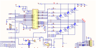

    1)The schematic is blurry and I can’t read part values, so could you please upload a pdf version?

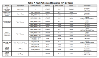

    3) An overcurrent scenario will lead to retry modes, but we see that the nfault is latched low. This suggests to me that we are seeing a gate driver fault. If the device is operational and not damaged then I would like to see if the latched fault always occurs. If it does then it might suggest that there is a short/damage causing the nfault to be low.
    4) If there is damage then we can perform impedance check on the pins to narrow down where the short has occurred.

    1)The schematic is blurry and I can’t read part values, so could you please upload a pdf version? uploaded

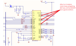

    2) I am still not sure on the damage you mentioned. What do you mean by damaged, which specific part? Is there a short or a burn? I am not observed any short or burn but after 2 or 3 rotation I noticed that VDRAIN pin goes low and SHX pin goes high. After removing all high side MOSFET, still I observed 48V on SHX pin.
    3) An overcurrent scenario will lead to retry modes, but we see that the nfault is latched low. This suggests to me that we are seeing a gate driver fault. If the device is operational and not damaged then I would like to see if the latched fault always occurs. If it does then it might suggest that there is a short/damage causing the nfault to be low. Latched fault always occurs, after power cycle we can able to run 2 or 3 rotations then latched fault occurs.

    Could you please  check the layout and suggest if any improvement is required? Is it possible to have a session on a teams meeting to check the layout with you ?

  • Hey Balabhaskar,
    Please consult the schematic attached below with my comments.
    On the low side turn off waveform, I am a bit concerned seeing the ringing. The voltage goes up to 3V which is higher than your MOSFETs Vgs threshold of 1.5V. This might lead to the MOSFGET turning on every time it occurs leading to a shoot through current. If this is the root cause you can use MOSFETs with higher threshold voltage (we can keep this as a last resort).
    Also, we measure slew rate time based on VDS not VGS. So, the rise/fall time is with respect to VDS. Based on the waveform provided I see a slew rate of ~20ns which is very fast. I would recommend lowering the IDRIVE till you get a slew rate between 100-200ns. Please provide a waveform once the update has been done. The fast slew rate can lead to dv/dt coupling (gate turns on) and can lead to shoot through current. The large spikes could also lead to damage during operation. Other than lowering your Idrive setting you can also increase the dead time to combat this issue.
    Trise/fall = QGD/Isource/sink
    You could also increase gate resistance to decrease gate current.
    What was the purpose of removing the high side MOSFETs? We don’t recommend spinning the motor without the HS mosfets.
    Would it be possible to provide a zoomed in waveform of the GHx, SHx, VM and Vdrain after implementing the changes recommended?
    Akshay05.ROLL1-TI Reviewed.pdf

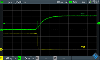

  • Hi Akshay,

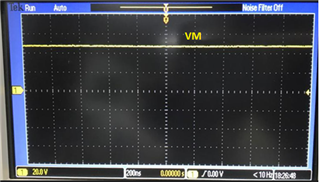

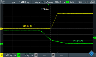

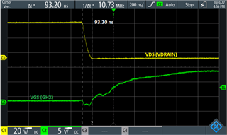

    IDRIVE  is reduced to 30mA source and 60mA drain and gate resistance is 33 ohm , waveforms captured are below after the changes
    High side MOSFET turn on
    High side MOSFET turn off
    Low side MOSFET turn ON
    Low side MOSFET turn OFF
    waveform for VM
     Other than lowering your Idrive setting you can also increase the dead time to combat this issue. DRV8323HRTAR, there is no option to change dead time setting.
    What was the purpose of removing the high side MOSFETs? We don’t recommend spinning the motor without the HS mosfets. We are getting 48V on SHX pins after 2 or 3 rotations in the Damaged DRV, So we removed the high side MOSFETs to make sure the current path is not via the MOSFETs. But we are still getting 48V on the SHX pins after removing the  high side MOSFETS.
