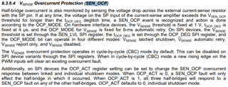

    • this implementation is not advised for the DRV8353's integrated CSAs, since you are effectively applying motor voltage (tens of voltages) as common-mode voltage at the CSA comparator, which is only rated for around 5V (logic-level voltages). See datasheet section below confirming my statement

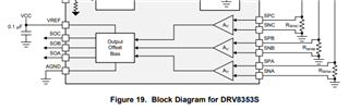

    From the official DRV8353 datasheet, here's block diagram implementation of DRV8353S variant you selected
    • this is referred to as 'low-side current sensing' and is how your integrated CSAs should be connected on the DRV8353S device.

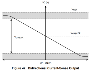

    2. the DRV8353's 'native' or 'integrated' CSAs should be connected such that a SEN_OCP fault does not trigger - and that the CSA isn't actively switching
      1. SPx=SNx=GND pins tied together (no input voltage differential) will ensure that the output voltage SOx is stable (hovers around Vref/2 in bi-directional mode)
      2. floating SOx pins ensures that the CSA is left alone, and doesn't introduce noise by leaking current on the node that you connect it to (e.g. GND)
