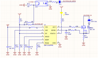

DRV110: DRV110 Schematic Values
Part Number: DRV110
Could you please advise the passive component values for application ?
DC Voltage: 28V
Desired Current 2 Amper
Solenoid resistance 4 Ohm
Thanks.

  • Hello Jacob,
    Please check the scope screen with the passive component values. After few seconds, MOSFET is getting hot, nearly 130C Degree. There is no problem except mosfet's temperature.
    Channel 1 is current probe
    Channel 2 is mosfet's gate signal.
    MOSFET: IRF3710
    Rpeak 480k
    Rsense 25mOhm
    Rhold 168k
    Rosc 168k
    Ckeep 1uF
  • Hey Alikaan,
    Just for my own understanding I went through and calculated the system settings:
    • Rpeak 480k --> Datasheet levels are 50k or 200k, this should be read as the 200k level, so VPEAK = 300mV
    • Rsense 25mOhm  --> Datasheet discusses 1Ω or 2Ω, but this should work
    • Rhold 168k --> VHOLD = 50mV
    • Rosc 168k --> PWM frequency 25kHz
    • Ckeep 1uF --> tKEEP = 0.1second
    • IPEAK = 1Ω*0.9A*66.67kΩ/480kΩ * 1/0.025Ω = 5A
    • IHOLD = 1Ω*0.150A*66.67kΩ/168kΩ * 1/0.025Ω = 2.38A
    This looks very similar to the this E2E post's "Size for 5A" schematic:  https://e2e.ti.com/support/motor-drivers-group/motor-drivers/f/motor-drivers-forum/1163630/drv110-schematic-check  They used the IRF7469PbF which is a less powerful version of your IRF3710PbF FET, so this design should work.
    Can you post your full schematic for us to look at?
    One thing you can try to reduce the temperature is by reducing the switching frequency. can you try to reduce the PWM frequency by adjusting Rosc. Test it at 1000Hz and measure the temperature. Does it go down?
    Jacob
  • Hi Jacob,
    By the way, this written values applied to DRV110EVM board. I'll test the reducing PWM. I'll let you know the test result. Also I have custom designed board, please check the values & schematics for same application. In custom board, with these values, MOSFET is burning is several seconds.
    Mosfet: CSD18540Q5BT
    Thanks!

  • Hi Jacob,
    I fixed the MOSFET temperature problem with changing the MOSFET with lower gate capacitance. Also I decreased the PWM freq. I just have abnormal gate drive signal sometimes as I mentioned above.
    Thanks!
  • Hey Alikaan,
    Glad to hear changing MOSFETs worked!
    The abnormal gate drive signal is an artifact of the hysteresis controller this device implements for current control - see 7.3.2 PWM Current Control.  It is nothing to worry about.  This device has a fixed frequency (25kHz).  It sensed the current was too high right before the new on-cycle, so immediately turned off the output to limit the current back to the desired level.
