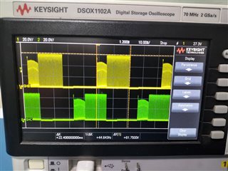

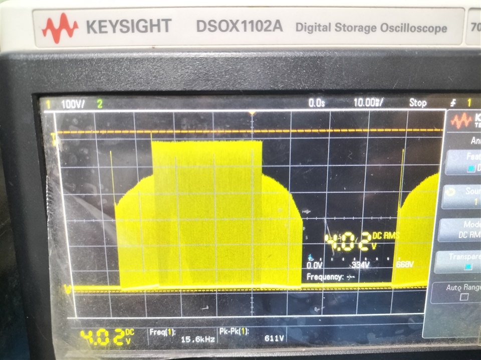

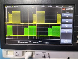

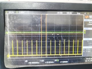

    Here is the trace for one of the Mosfets gate. It should be trapezoidal, but can't figure out the reason for the following shape.
    Is it GHx, GLx, or Watergate? Without know the voltage/division -- not obvious to me -- I don't know what I am looking at. Please don't let us guessing as no help to you.
    Brian
  • The given trace is for GHA. Same traces observed for GHx and GLx. Other details about the circuit ias as follows:
    If the waveform is GHx, then it should be in 16khz PWM shape, not trapezoidal. Why do you expect it to be trapezoidal (or sinusoidal in an idea case)? You have to do a low pass filter in order to see the trapezoidal shape of the 6-step Hall commutation.
    Brian

  • GHx is 16khz pwm and should have the same peak voltage instead of a trapezoidal shape. What is the time T shown below?
    The captured scope waveform missed many important parameters such as the voltage scale and time scale, and so I don't know if the pic shows many hundreds pwm cycles or something else. Again, there is no reason for the GHx to have different voltage level as shown.
    Brian

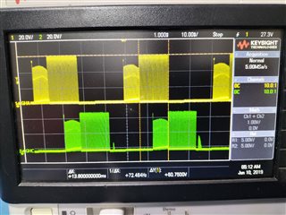

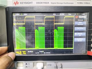

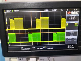

  •   Hi Alicia, as per your suggestion here is the plot of HALL Sensor A (yellow) and SHA (green). The small bump at the beginning (right) goes to the end (left) if I change the direction of the motor. Also, I tried changing the bypass capacitors at the hall sensor input to 1 uF instead 1 nF, but no difference. This plot is for 1 uF setting.
    Hall signal looks normal. SHx could be distorted due to motor BEMF, so why not capture GHx together with Hall signal, as it should have the same peak voltage every pwm cycle.
    Brian

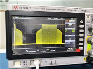

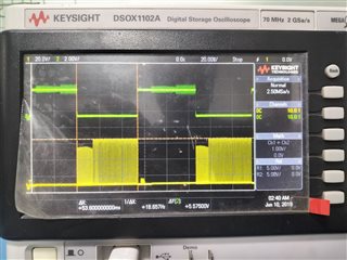

  • GHA (yellow) and HALL A (green)
    The peak-peak voltage for hall Sensor is ~ 3.3 V as expected.
    The peak-peak voltage for GHA is ~ 5-7 V .
    The time period for the entire waveform between each hall A trigger is 53 ms.
  • Also when I zoomed in on the plot which itself is made up of several square waves.
    OK, now we get something.
    The GHA has 3 levels: 0v, HV1, and Hv2 where HV2 > HV1. Let me explain why we see two level HV1 and HV2 instead of just HV2. During 6-step Hall commutation, each phase goes through 3 states: 0v (with lower FET turned on), HV2 (when upper FET turned on) and floating at HV1 (when both FETs turned off), according to  the table below. During Fets turned off, the voltage at SHA is driven by the other phase that being PWM via the motor coils.
    So nothing is wrong with the waveform and you should not expect to see a trapezoidal waveform.
    Brian
    These are 16khz pwm square waves as expected.
    Brian

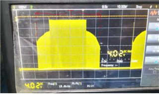

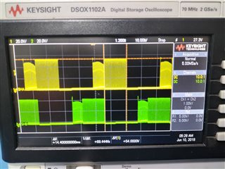

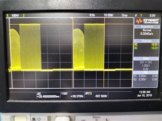

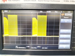

  • Here is the phase voltage for coil A. Vin = 51.1V, PWM is at 16 kHz and 10% duty cycle. Peak to peak voltage 50.1V.
    IDENTICAL traces for coil B and coil C too. With same peak to peak voltage of 50.1 V.
  • BOOSTXL SHA.
    GHA for BOOSTXL BOARD

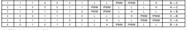

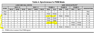

    The Boostxl waveform conformed to the table below, but your customer waveform does not. I will point out where is the problem as I continue to edit this post because I couldn't add more pic to it for some reasons by the forum website.
    Each commutation cycle is about 8 divisions based on scope capture, and so there are 3 equal parts on the time scale: 2.7 div pwm, 2.7 div zero volt (low FET turned on), and 2x of 1.3div of floating voltage (both FETs are off). Let's look at phase A on the table below: hi-z, then 2x pwm = 2.7div, then hi-z, then 2.7 div of 0V. This logic is matched with the waveform above.
    Now, let's look at the customer waveform: each commutation cycle is about 5 div, so the pwm = 1.8div and 1.8div of 0v. The floating is about 0.8div each. This issue is right after the pwm section, there is no floating FETs but instead the lower FET is ON. This caused the problem and the motor noise. You should look to see why the lower FET is turned on instead of off at step 4 of the 6 step table below.
    Are you using 1x PWM mode or some other input mode?
    Brian

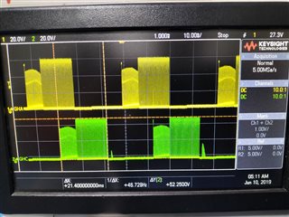

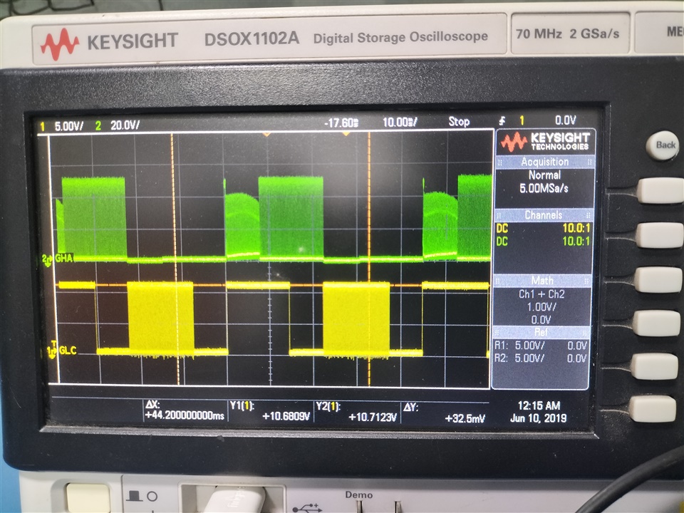

    The peak-peak of GHA of 5-7v is super low; you should double check as I don't believe it - with 51 on the FET Drain, there is no way the high FET can turn on with just 7v p-p.  Also why I couldn't tell the v/div on your captured scope screen? Can you teach me how to read the signal voltage on the scope?
    I expect the GHA signal to have the "float" level right after the PWM section, just like the "float" before the PWM.
    Could you capture these signals on the same screen: GHA, GLB, GLC. This will help to explain why GHA has the weird shape.
    Brian

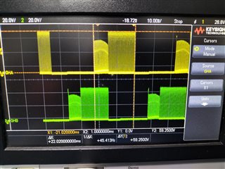

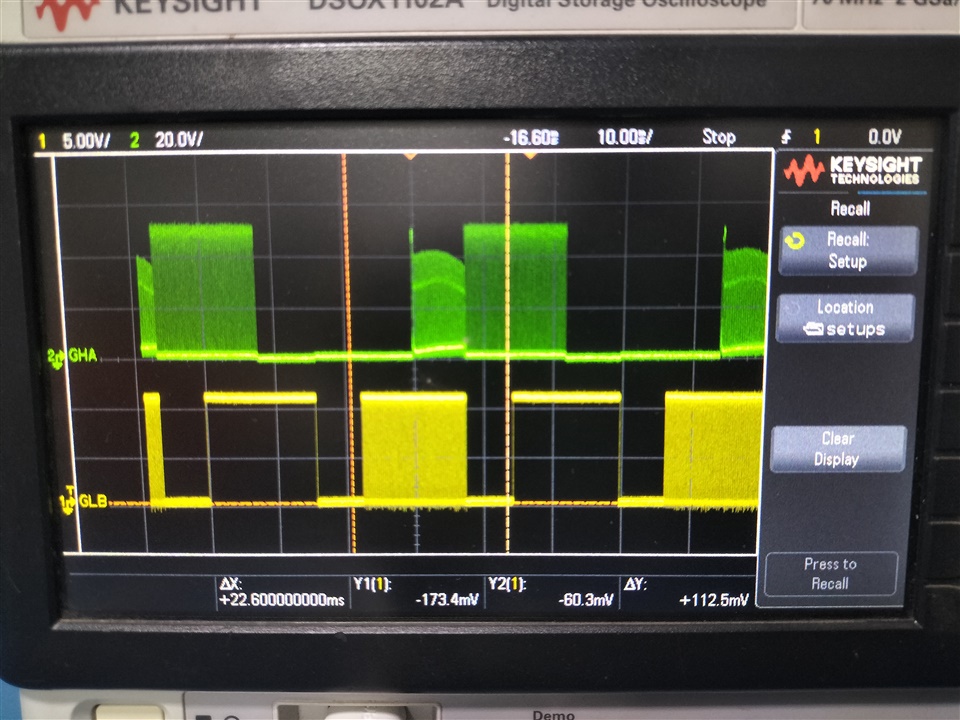

  • Hello Brian, here are the traces you asked for. VM = 51.4 V, PWM = 16 kHz, 10% dutycycle
  • I am using  1x PWM mode for which MODE pin is left open (Hi-Z state) as mentioned in DRV8323 datsheet.
  • Also, the pwm is generated using and extyernal square wave generator at 5V peak to peak voltage and the ground and PWM o/p pin connected to that of drivers ground and PWM pins.
    Hi Aniket,
    To make life easier for everyone: line up the waveform bottom 0v on the grid and the pwm cycle (the period of each cycle) start point on the grid. This practice helps to measure the voltage and time much easy than what you posted.
    I will check out the scope captures.
    Brian

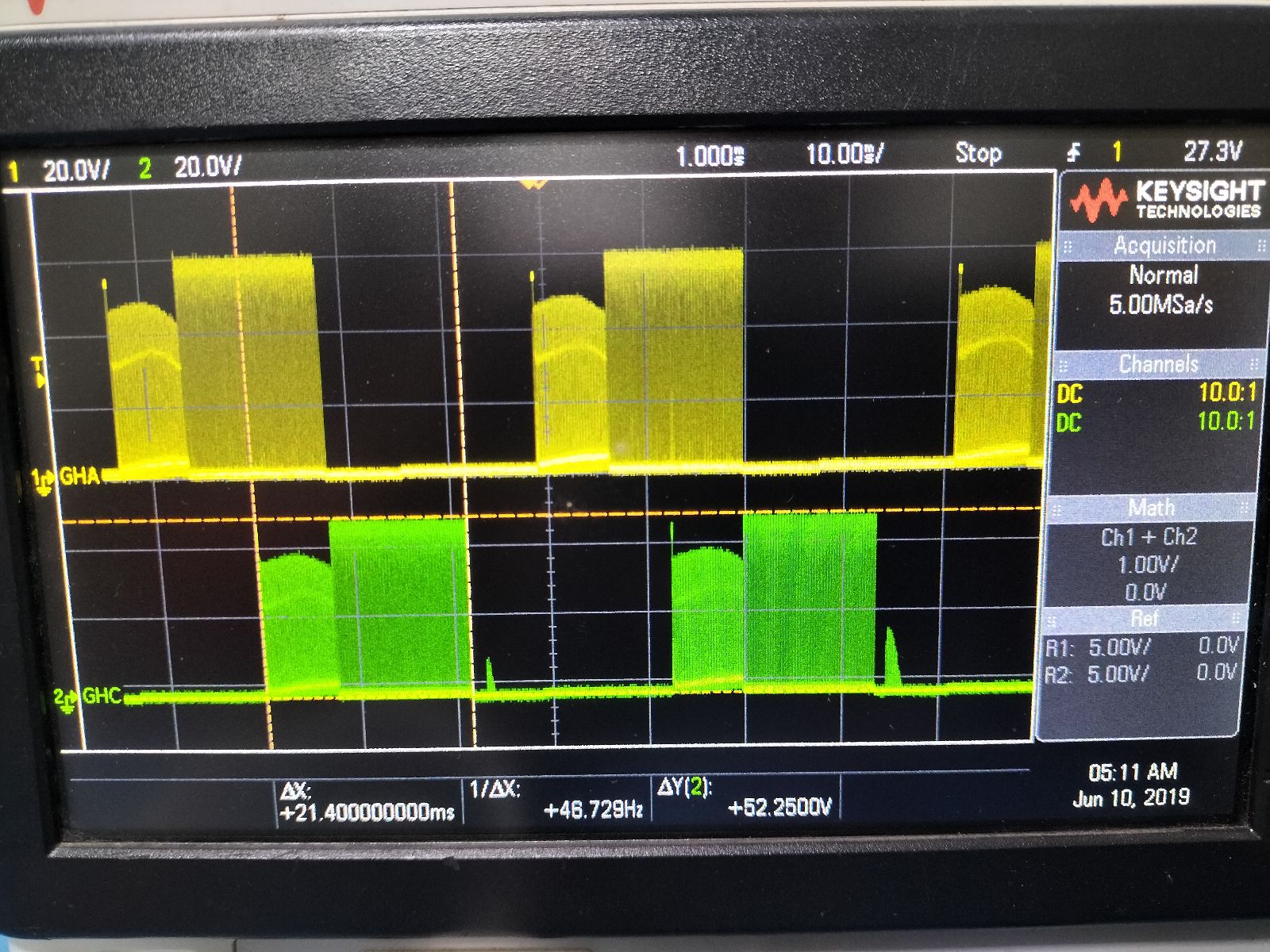

  • Could you capture these signals on the same screen: GHA, GLB, GLC. This will help to explain why GHA has the weird shape.
    Hi Aniket,
    I asked for GHA and GLB, GLC. Not all GHx as you had captured. The GLb and GLc will help to explain why the GHA doesn't have the floating section after the pwm. Pay attention here: Gate Low B and Gate Low C, not GHB and GHC.
    Why do I want to see GLB and GLC? if they turned on then the lower FETs are grounded which cause the missing "floating" section on GHA.
    Brian

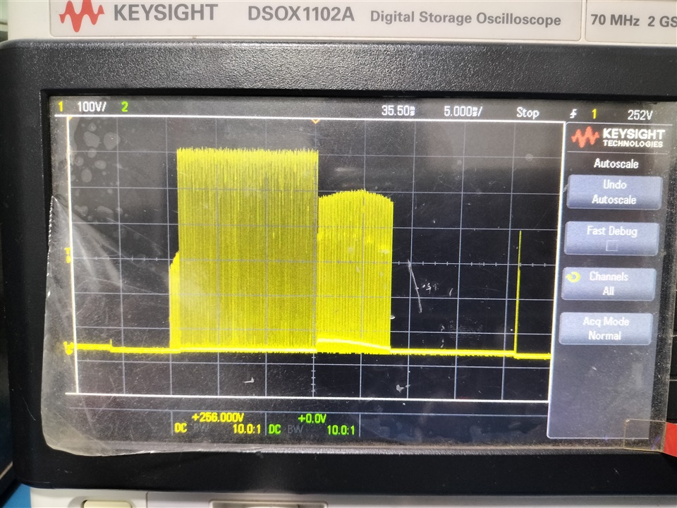

  • Also, what's wrong with your scope or probes: Some pic with waveform having 3 div p-p, and some with only 2 div p-p? Are these waveforms captured with the same supply to the FET drain of 52v?
    Brian

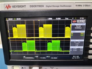

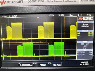

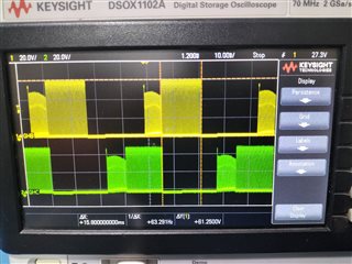

    I think the root cause of the problem is that the Hall sensors are connected incorrectly to the driver chip input pins.
    For output SHA, during the normal pwm section, the Hall A signal should be high, not low.
    Check if the Hall sensor signals are inverted on the board.
    Brian
    Could you post the scope waveform of SHA and SHC captured together on the same pic? Pic below shows the GHA and GHC, but I want to see signals at SHA and SHC (which are connected to the motor wires).
    As I pointed out before, the Hall signal relative to the GHx signals are inverted. However looking at the all the gate signals, GHx and GLx, and they don't seem to cause the problem of missing "floating" section after the PWM section.
    Brian

  • Hello Brian, I did check the hall sensors and everything is as described by the DRV8323 datasheet.
    Really? Pic below shows GHA and GLA are pwm during Hall A is low, and you are saying it is correct based on the 8323 datasheet?
    Look at the table below and tell us at what step in the table that  GHA with pwm when Hall A is low. I had pointed to this problem 7 days ago. There are only 6 steps so you have 1/6 probability of point to the right step, but I am sure you can't find the correct one.
    Brian
