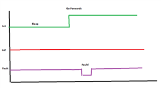

From 7.3.2 i understand there will be a erroneous FaultN pulse every time i leave sleep mode - which is quite frequently!
is my sketch below a correct understanding?
How can i distinguish a genuine fault from the error fault when leaving sleep?
