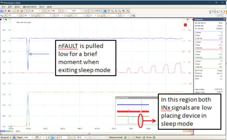

    Have you taken a look at the nFAULT signal? If you have, can you send a scope shot showing IN1, IN2, and nFAULT? I want to confirm that this is an OCP event being triggered.

  • Hope you had a good weekend Pablo? Mine was busy with scopes and wave-forms.
    Please see attached pdf file of descriptions and traces...

    • I'm not 100% sure, based on the scope shots, if an OCP fault is really happening when you stall the motor. Do you have the capability to use cursors to measure the time delta between the region marked by the black lines shown below? It looks to me that the motor begins to stall when the Isense voltage begins to rise to ~200mV. This device has a typical OCP deglitch time of around 2µs. If the time delta between this region is close to 2µs, this will give me more confidence that an OCP fault in indeed being triggered.
    • I'm very puzzled as to why nFAULT is dropping low right before starting up the motor (like you show in figure 4). What are you using for the main power supply? A DC battery or a bench power supply? My main theory for this phenomena is that there might be some part of your circuit drawing some significant amount of current at that point which surpasses the current limit set by you power supply and causing the voltage to drop momentarily. This might cause an under-voltage fault which self-clears when the supply voltage goes back to nominal value. I will research this more because this event is very strange. I'll keep you updated on what I find.

    I looked through your report and here are some of my comments:
    • I think I found an explanation for the sporadic nFAULT drops. This device goes to a low power sleep mode when both IN1 and IN2 are low for a certain amount of time. The device is pulled out of the low power sleep mode when either of the INx signals is HIGH. However, when the device is exiting sleep mode, nFAULT is pulled low for a brief moment (this is described in section 7.3.2 in the datasheet). If you look closely at the waveform you attached in the previous report you sent (waveform is attached below), the device goes to sleep mode when both INx signals are low but nFAULT is asserted when the device is pulled out of sleep mode.
    • My main theory as to why nFAULT is staying low when placing device in BREAK mode is that the INx signals are going high very quickly after nFAULT drops which is violating some internal logic timing. A good quick experiment you can try doing is to add some timing delay to the signal that is changing states. For example, if IN1 is "1" and IN2 is "0" and after the stall happens and both IN1 and IN2 are "1", add the delay on IN2. You can add delay by adding either a capacitor on the signal line or adding some inverter gates in series with the signal trace. If you know other more efficient and easy ways to add delay, feel free to use those methods.

  • Hey Pablo,
    Here in the UK we don't have a labour day....our holiday was last weekend.
    Yes you're right about the FAULTn signal exiting sleep mode, I had forgotten that.
    I will try to slug one of the INx signal somehow and let you know.

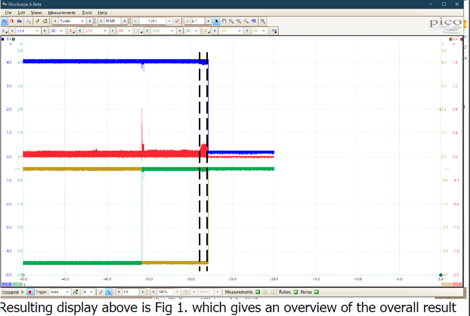

  • Dear Pablo (and Don),
    Hope Labour Day was peaceful for you - some parts there are not so peaceful :-(
    I managed to slug IN1 and IN2 (with a 47uF cap) to give a 600us delay after FAULTn asserts - but no differences detected - it still fails to de-assert. See attachment.
    Should I try for more delay - eg double the 47uF cap? Somehow I don't think so. It seems that the OCP logic is confused by the rapid assertion of a BRAKE condition. I will avoid BRAKE on the next re-spin.

  • Sorry for delay Pablo - I was doing some field trials on my door opener and your DRV8832 (which were successful, but no motor stalling)
    So I tried double, 2 x 47uF, no change then added a 330uF cap to the 2 x 47uF (total 424uF) - still no change to FAULTn.
    Then I caused one of the INx signals to fall by connecting a discharged 330uF in it's HIGH state - this released FAULTn !! - see last trace of the attached.

  • Tim,
    This is very interesting. It seems like the internal logic does not like it when INx signals are forced HIGH after nFAULT drops low. I am definitely going to research this issue more and try to understand what exactly is happening internally. It will take me a few days to do my research but I'll let you know what I find out. Expect a reply from me by Wednesday of next week or earlier.
