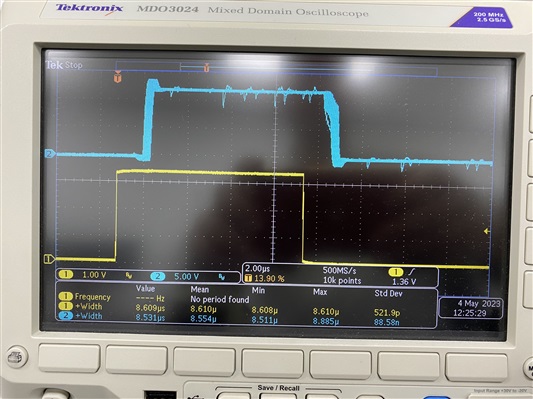

During PWM operation i'm measuring ~300ns jitter on the motor outputs of this driver. Is this normal?

  • Hi Pablo,
    Thanks for following up.
    Attached is an oscilloscope grab with persistence hold.
    • Blue trace, motor output terminals, ~374ns max jitter output
    • Yellow trace, corresponding channel enable input, ~2ns max jitter input
    Sam.

  • Hi Samuel and Brian,
    When the device is not in current regulation mode, the output will follow the input PWM signal and is not affected by the digital clock frequency jittering. However, when the driver is in current regulation mode, the control inputs (INx) are ignored and the driver itself controls the states of the outputs. In this case, digital clock affects the jittering at the output.

  • Hi Pablo,
    I have re-checked without any load attached, I'm still getting similar jitter readings ~347ns. So it would seem unlikely that PWM current regulation is being applied.

  • Hi Samuel,
    I just want to know if this level of jitter could be classified as ‘normal’ for this IC? It seems that this is the case for other TI DRV series IC’s such as the DRV8872 and possibly others.
    This jitter is to be expected for this device.
