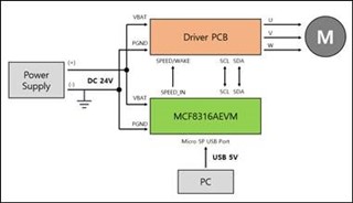

** H/W configuration **
- Customer Driver PCB / EVM B/D(GUI interface) / PC(GUI)
** MCF8316A-GUI **

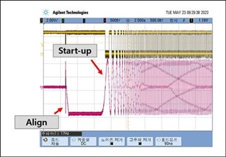

1. If you increase the rotational speed in the "Testing for successful start-up into closed loop" step, start the closed loop drive after aligning.
The waveforms below are Frequency Generator (FG) and U-phase phase current waveforms.
From the start of the drive, the phase current amplitude is gradually reduced (PI controlled) and the MPET estimates the motor parameters.
The Tuning Guide states that it may take 10 to 15 seconds, but this will continue for more than 1 minute.

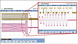

Then suddenly the motor rattles and stops running, and the whole process stops.
There is no fault, and it does nothing at all.
If you zoom in on the waveform when it is rattling, the phase current rises as the Estimated Theta is distorted, and then the control stops.
