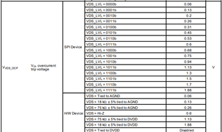

  • I experimented with different VDS settings and found that the nFault Pin goes low at different values of current. I want my system to trip / report Fault at around 20A current draw. Can you please suggest me how to select the appropriate resistors for the same.
  • Please refer to this table from the datasheet explaining how to select a VDS trip voltage:
    To convert the VDS trip voltage to the current level you want, please refer to the Rds(on) value of MOSFET you are driving.
    The VSEN trip voltage is set at 1V for the hardware variant:
    You can choose your current shunt resistor per the current level you want to set. I would still recommend going through the Fault debug process mentioned earlier to confirm whether an overcurrent situation is causing the fault or if there is another issue.
    Again, the nFAULT might be not triggered by the VDS setting, but by other causes such as supply under voltage. How do you know nFAULT was triggered by VDS and not something else?
