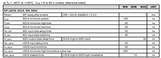

  • Hi Wu,
    Can you confirm if your SPI protocol is following these timing requirements?
    I am a little confused by the scale of the timing marker in the images you sent, and want to check in particular whether the SDO output data delay time might be causing the mismatch between the MISO signal and the clock. As far as I can tell, the returned read data on MISO appears shifted right by one bit in your images, but the bits themselves otherwise look correct.
