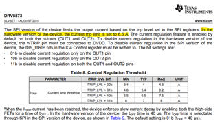

    2.Here is descriptions in drv8873 datasheet:
    "R(sensor) = k x 5 / Io (k is typically 1100)
    In the hardware version of the device, the current trip limit is set to 6.5 A. The current regulation feature is enabled by
    default on both the outputs (OUT1 and OUT2). To disable current regulation in the hardware version of the
    device, the nITRIP pin must be connected to DVDD."
    If I want to set current trip limit to 8A, the R(sensor) should be about 688R, and need to connect the nITRIP pin to DVDD. My question is I have do this but the output current always less than 6A, below is my test steps:
    (1) Set IN1 PWM duth as100%, IN2 PWM duty as 0, the motor forward at full speed;
    (2) Forced blocking motor;
    I think when forced blocking motor, the output current should be about 8A, but the output current was always less than 6A and then it stoped. It seems that I didn't set the current limit to 8A success.

  • Hi Cherry,
    The DRV8873H is the hardware version of this device. The hardware version offers less flexibility in terms of current regulation. The DRV8873H has a set current trip limit of 6.5 A.
    The SPI version of this device can be configured to have a typical ITRIP of 7A and a max of 8A.
    The hardware version also only has a fixed TOFF time of 40us.
    When ITRIP is reached the device will enter slow decay by enabling both high-side FETS.
    While in current regulation, the inputs can be toggled to drive the load in the opposite direction to decay the current faster.
    David

  • Hi Cherry,
    Yes, the ITRIP threshold is set to 6.5A but should be configurable for output current values less than 6.5A.
    In order to decay the current faster, in current regulation, the inputs can be toggled to drive the load in the opposite direction.
    This switching between forward and reverse drive should help stop the motor more quickly.
    Forward: IN1 is 100% duty cycle and IN2 is 0% duty cycle
    Reverse: IN1 is 0% duty cycle and IN2 is 100% duty cycle
    David
