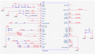

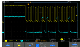

  I designed a new PCB with the MCF8316A and the controller mcu is stm32F0 MCU.  I send  the first byte with the 0x01 address and the write bit, there is no ack bit from the MCF8316A.
The following image shows the schematic diagram and the waveform captured by the oscilloscope of the iIC bus transmitting 01+w.
  I also measure the votage of AVDD and DVDD ,  AVDD= 3.3V   DVDD = 0V. So  is  there any problems with my circuit design?
  • Hi liu,
    If DVDD is at 0V this indicates that the logic core of the MCF8316A does not have power, this is why ACKs are not being received from the device.
    In the schematic you provided there is no connection to FB_BK, which is used to power DVDD. If you choose to not populate the buck components we recommend connecting AVDD to FB_BK. If you choose to leave the buck components un-populated please refer to question 7 of our Common MCx Schematic and Layout Q/A FAQ for more information.
    Joshua

    There are only two points in the schematic that could be a problem:
    1. DRVOFF being pulled high with no connection to pull it low, but it seems like this connection is just not shown since you say you are measuring it at 0V
    2. We recommend placing higher capacitance between VM and PGND, typically we recommend 330uF, to help with startup current demand
    Can you measure the voltage at the pins AVDD, DVDD, VM and CP, these should be equal to 3.3 V, 1.5 V, >4.5 V, and ~VM+4.5 V respectively.
    Joshua

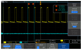

  • Hi Liu,
    Could you provide me a capture of the input frequency waveform?
    Could you also tell me the value of the ALGORITHM_STATE register when attempting to drive the motor?
    Joshua
  • Hi Joshua,
      the input frequency waveform is as follow, the pwm input frequency is 30KHz and the duty is 20%.
     the REG ALGORITHM_STATE  value is 0.
