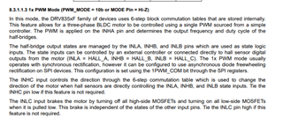

In this we have connected the HALL Sensor and the Motor U ,V , W connections and we have used 1X PWM mode.
After Giving the PWM frequency we could not able to run the motor. We have given the frequency of 25KHZ.

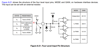

    1) Have you ensured that the correct mode is being set in the device using the MODE pin and that THE APPROPRIATE INPUT SIGNALS ARE BEING SENT TO THE INHX and INLX?

    We are using 1X PWM mode in our design .
    We are giving PWM pulse on the INHA pin and connecting the hall sensor as recommended in datasheet.
    We are receiving the  signals(20KHZ frequency,50%duty cycle) at the inputs, But the motor does not rotate and sometimes the board gets heated.

    Also We have connected the Motor driver to MCU and we are using 1X PWM Mode.Hall sensor has been connected to INLA,INHB,INLB and we are giving frquency of 20KHZ,But we could not able to change the frequency more than 20KHZ.

    Would you be able to provide the waveforms I requested for us to analyze? also did you try to set the 1x mode by floating the mode pin instead of the resistor?

    We have tried in 1X pwm mode by floating the pin

    Have you checked INHA to ensure that the pwm signals are being sent? And also please check if the hall signals are being sent / commutating correctly as well.
