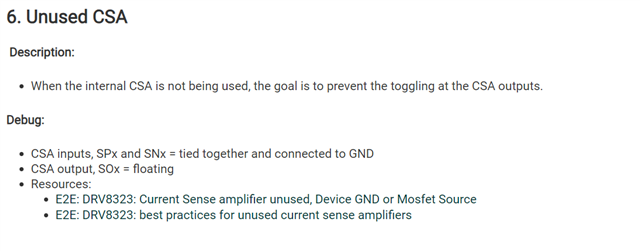

There're two questions about DRV8353RS in e-scooter application.
1. There're only two current senses of U and V phase being used and the W phase can be calculated by MCU. How to deal with unused pin of the SPC, SNC and SOC? Can one of current measurement phases be disabled by SPI register?

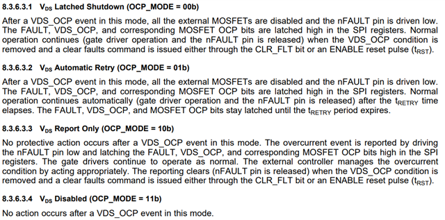

2. On bench testing, customer found when OC event is happened and nFAULT is activated, all LOW side MOSFETs are turned ON. Why all gate drivers are not disabled after OC event is triggered?
