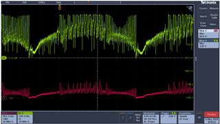

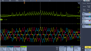

I am using DRV8329 to spin 3 Ph BLDC motor on one of our Project. this is a key project we are working and has very high annual volume ( > 50k)
we are evaluating the possibility of using CSAGAIN and SO pin to read the current from Motor and have Connected CSAGAIN To GND to read max current. Peak current (motor phase) in my application could go up to 90A during startup at load.
I am getting good data on the SO Pin but the voltage does not match with gain mentioned in the datasheet.

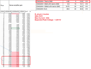

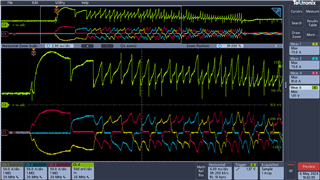

with CSAGAIN to GND I calculated table in above image. below are scope captures of Motor Phase current peak value and SO pin voltage wrt GND. there is clear offset of 400mV to 800mv which is very high. see below captures for reference

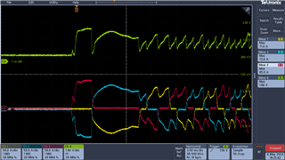

Peak current at startup is 81A, according to table, SO Voltage should be close to 1.24V but i am seeing 1.92V here, some more images below during operation

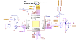

Request you to provide some feedback on the discrepancy observed. Below is snapshot of DRV8329 section.
  • Hi Abishek

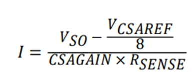

    What formula are you using for this calculation?
    When did this issue start? Was there a point where the device behaved properly at peak current?
    Yara
    this is a formula from datasheet.
    we initially were focused on other functionalities of tool and when we started validating overload protection, we looked at SO voltage measurement. therefore the readings are same, so i believe issue is from beginning.
    CSAREF is pulled to AVDD as you can see in the snap.
    Abhishek

  • Hi Abhishek,
    I think the "offset" you are seeing is really just Vcsaref/8. You would need a negative current to actually get Vso to equal 0 because if you have 0 current then Vso would equal equal 400mV. Is this what you are seeing across all gain setting or only 5V/V?

  • Hello Yara,
    you are correct, i do see offset of ~400mV. it can be seen in the waveforms as well which are attached in 1st post. even if i subtract that offset, peak value of current and peak value of  SO voltage does not match. This is main issue. Offset is going up to 800mV in some cases or even more.
    For peak current of 85A, with offset of ~420mV, peak value is 1.98V and with Calculation by formula, it should be ~1.27V.
    it becomes difficult  to put formula in firmware to get close to accurate current reading.
  • Hi Abhishek,
    Is this offset consistent across all the gain settings? Meaning is the offset greater when using 20V/V for the gain setting?
    Yara

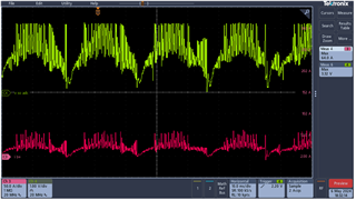

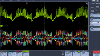

  • Hi Yara, yes higher offset is at 10V/V as well. i had connected 50k. you can see waveform below.
    SO voltage is saturating to 3.3V at 65A only. if you refer the graph above again
    with 10V/V, at 65A, the max value should be close to 1.68V but SO voltage is already saturated.
    so it seems the offset ERROR is amplifying with higher gain

  • Hi Abishek,

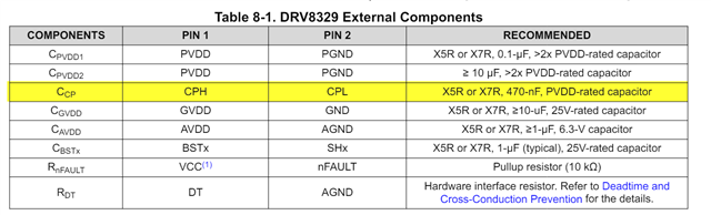

    Apologies for the delay. I took a closer look at your schematic and it seems like the value for the charge pump capacitor is incorrect
    it should be 470nF or 0.47uF
    This is a critical component and should be changed, and hopefully this will resolve your issue.
    I also made a table based on the min and max value for CSAREF and CSA GAIN variable in this equation
    VSO Calculations.xlsx
    Let me know if your issue is resolved
