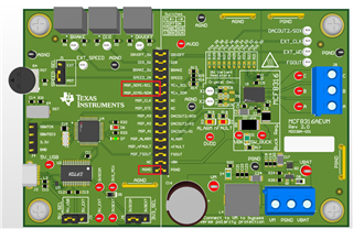

Second, I don't want to go through all the trouble of building out custom software / firmware if there is an easier way. I see that the GUI for the EVM board has a nice / easy interface to make all the configurations needed. Is it possible to use the GUI to configure a MCF8316A that is not on the EVM board? I am trying to design a first proof of concept device which requires a smaller form factor.
    It is possible to use the GUI to configure a MCF8316A that is not on the EVM. To do this you will need to connect the SCL, SDA, and AND pins of the external MCF8316A to the MCU_SCL, MSU_SDA, and AGND pins on the left side of the J6 header on the MCF8316AEVM.
    Alternatively, you can use the code example in the Program MCx BLDC motor driver through I2C using MSP430 LaunchPad FAQ to program a register configuration made using the GUI+EVM into a MCF8316A device not on an EVM.

    That is great news about the off-board EVM! To be clear, once the GUI is used to configure the off-board MCF8316A there is no longer a need to have the connection?
    Once you have the configuration set in the GUI that works, you can write this register configuration into the MCF8316A's EEPROM which will be loaded into the registers at power up. Once the configuration is written into EEPROM, the MCF8316A will not require a connection to an MCU to drive a motor.
