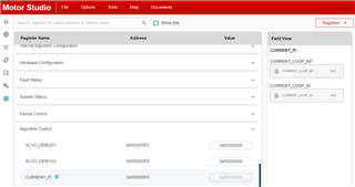

I want now to optimize the MCF8315 parameters, in particular the Current_Ki and Current_Kp which I defined arbitrarily. Doing that I have the following issues:
  1. According Motor Studio and to the IC labeling the IC on the board is the MCF8315C, though it is a 40 pins IC and according to the latests MCF8315C datasheet it only comes with 32 or 24 pins, this also leads to having a single DACOUT documented on the datasheet though there are two available
  2. I am using DACOUT1 and DACOUT2 and it seems they are inverted in the MCF8315EVM test points?
  3. How to optimize Current_Ki and Current_Kp? As far as I see MPET does not do it and there is no guideline on the application notes, I see though that some values make the closed loop not to work
  4. Using DACOUT1 and DACOUT2 I am trying to output internal signals for debugging and some (most) seem not to work, for instance PHASE_CURRENT_A, B and C work, but these others do not work: PHASE_VOLTAGE_Vx, THETA_EST
  5. I moved from MCF8316 to MCF8315 because the available current settings were not suitable for low current motors, with the MCF8315 it has improved but still some settings (like current limits) are not well adapted to my motor, is there another part number that could work better for this current range and that implements FOC?
  6. While using Motor Studio on the Quick Spin page, some times clicking on the Inductance field makes the inductance value to be displayed in binary (for instance 111111) and then when moving to another field it mistakes that value for an actual entry and replaces it with the maximum inductance (20 mH)

  • Hi Nicolás,
    The MCF8315EVM should be populated with the 40 pin MCF8315C-Q1: https://www.ti.com/product/MCF8315C-Q1. If you would like to confirm this please check if the chip's top side symbol is: MCF8315ACVQ1
    Can you provide me with a bit more information about the issue you are seeing with these two DACOUT test points and/or pins?
    When a speed command is given, the internal algorithm of our MCx devices will automatically determine the current loop gains when CURR_LOOP_KP and CURR_LOOP_KI in the CLOSED_LOOP_3 register are set to 0x0.
    The current loop value calculated by the algorithm can be seen by reading the CURRENT_LOOP_KP and CURRENT_LOOP_KI bit fields in the CURRENT_PI (address 0xF0) register.
    The MCF8315 is the lowest current motor driver we currently offer which integrates a sensorless FOC algorithm.
    I have captured this as a bug so it can get fixed with the next Motor Studio update.

  • Hi Nicolas,
    I'm looking at DACOUT1 test point on the board with an oscilloscope and I see what I configure to see in DAC_2 register. The same inverted behavior is observed in DACOUT2 test point.
    Your observation is correct, DACOUT1 is affected by DAC2 and DACOUT2 is affected by DAC1. We are working to address this confusion in the future.
    the SPEED_PI register that has KI and KP values that don't match what MPET produced, is this an independent optimization output for the speed constants?
    When using speed mode two PI loops are enabled, the speed PI loop and a current PI loop. This register contains the current loop KP and KI which are determined by the algorithm during run time not by MPET. The algorithm will auto determine the current loops Kp and Ki at startup when CURR_LOOP_KP and CURR_LOOP_KI in CLOSED_LOOP3 are set to zero. If a different PI loop performance is desired by the current loop these values can be manually set.
    Joshua

    THETA_EST: This value should be able to output but it may look odd if DACOUTx_SCALING is not set correctly.
    Please try setting DACOUTx_SCALING to 15/8 and the waveform should appear like in the image below (please ignore the label):
