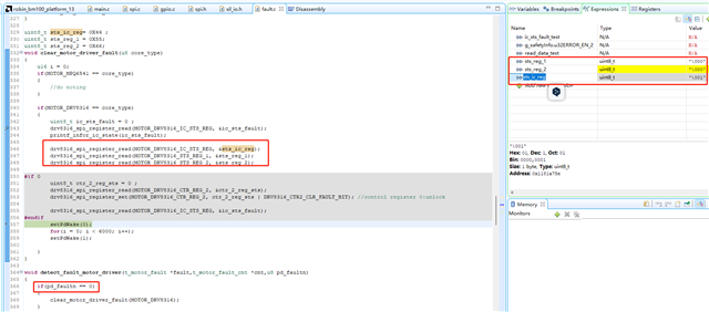

I have a question about IC_Status_Register Register:
Scenario:
I don't have a motor hooked up, and after running for a while, the nFAULT IO is pulled low and the value of IC_Status_Register Register is read as 0X01, which means that only the Device Fault Bit is set.
Question
1. what is the definition of Device Fault Bit, I didn't find it in the datasheet ?
2. whether Device Fault Bit represents a total fault, but other sub-faults are not set?

  • hi,Joshua
       1. I tested it with load and hall disconnected.
       2. I added 3 status register lookups and I can see that only the IC_Status_Register Device Fault Bit is set, none of the other variables are set

    When the device is reset through a reset pulse/fault clear bit, does this fault go away? If it is not able to be cleared it may be indicative of a broader device fault that may register on the device that does not fall into the fault status categories, such as a fault caused by DRVOFF. It may also be an issue in the reading of the registers, so can we confirm the proper addresses are being read? Experimentally you could trigger an undervoltage fault to observe if the registers are being read appropriately
    Does this fault trigger at any specific point during operation, or is it random? Can you also try using an actual BLDC motor to test with to observe device behavior?
