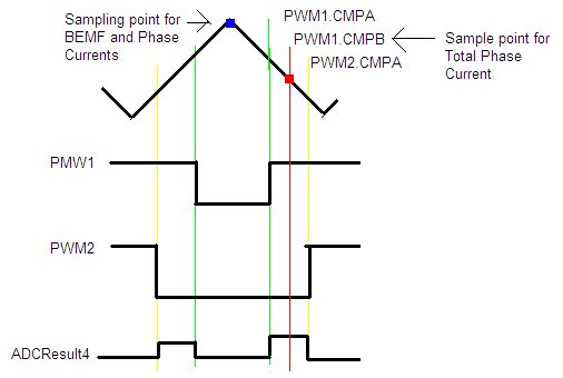

According to the FOC theory, the phase current should be directly measured from the stator. However, the schematic of DRV8301-HC-C2-KIT shows the current shunt resistors are at the low side of each half bridge. The method should be equivalent to direct phase current measurement. How can I understand it? Thanks
