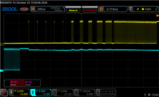

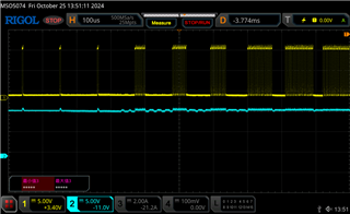

1.Is the waveform normal? Can it be further optimized and improved?
2.Can the operating noise of the motor be optimized?
Motor's A1 &B1 voltage waveform

A1 zoom in

Hi Gabriel,
Those waveforms you shared look what is expected from this driver. However these are AOUTx and BOUTx voltage waveforms which does not provide any information about the motor coils A and B current. Please look at the A and B coil waveforms using a current probe. This will reveal if the drive is optimal or not for the step rate and current setting. Thanks.

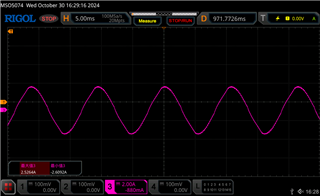

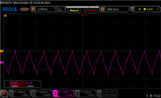

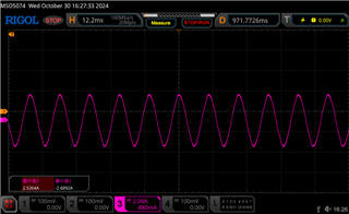

Dear Murugavel
Two different waveforms of current are used to drive motors with two different frequencies.
Hi Gabriel,
Thanks for sharing the current waveforms. They all look normal. The sine waveform distortion happens when the VM is not sufficient to driver the desired target current through the coils at faster step rates. For example the triangular current waveform will become sinusoidal if VM is increased from the present voltage level. Of course it must be less than the max recommended operating voltage of the device which is 48V. The triangular current waveform will have audible noise the sine waveform will let the motor run smoothly with low audible noise.
