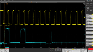

    Could you measure the DC voltage on SCL when sending these transactions? I want to make sure the DC level on SCL is above 0.63V and the device is not trying to enter SHUTDOWN mode while data is being sent.
    Yes, we measured the DC voltage on the SCL line during the transactions. We observed that the DC voltage drops to 0V between read/write cycles, as shown in below image. During actual read/write operations, the SCL levels transition between 0V and 3.3V, following the clock signal.

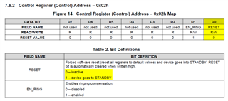

    We have tried to read the RESET register parallelly when DR201 resets but haven't seen the RESET bit getting change and that could be due to "RESET
    bit is automatically cleared when written high." as per datasheet.

  • Hi Jay,
    Is there any way you could use a o-scope to capture the I2C communication. This would give us more insight to the rise time and voltages of the signals. It could also be helpful to send the Salaea files (.sal) for use to look into.

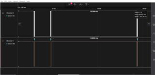

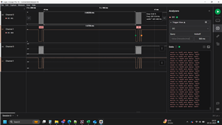

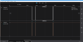

  • Hi David,
    I am Nisarg and working with Jay. we have captured the i2c signals (i2c clock and data) using Saleae-device and attaching the ".sal" file (.sal included in VCM_ISSUE_3_Final.zip file) along with this comment.
    Using oscilloscope, Very hard to measure and capture the i2c-clk reset issue in time frame.
    For voltage level, we have attached below screenshot for i2c-2 clock and data voltage level. (Captured in Normal-Condition)
