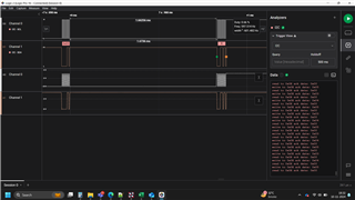

We are using the DRV201 VCM driver for camera lens movement with AM62Ax processor. DRV201 is working fine until too much data send and receive happens on that i2c bus. We have observed that when there are too many transaction on the i2c bus on which drv201 is connected, we see SCL is pulled low for more than 0.5ms. according to DRV201's datasheet "The device remains in ACTIVE mode until the
SW_RST bit in the CONTROL register is set, SCL is pulled low for duration of 0.5ms". So looks like DRV201 VCM is getting reset when SCL is pulled low for more than 0.5ms. Please check signal of that i2c bus when clock is pulled low more than 0.5ms.
How can avoid the clock stretching more than 0.5ms from AM62Ax processor side. So, that won't affect the VCM.

    VCM is connected on i2c bus 2 of A53 core. Linux kernel is "6.1.46-rt13-gb871cdee8c". We are using the RT-Linux.
    There is no other device on that i2c bus apart from VCM-DRV201. There was image sensor but we have disconnected image sensor and did continuous register read DRV201 and observed DRV201 reset.
    We have tried to change the i2c bus frequency from 400KHz to 100Khz but issue remain same. We have checked i2c signal i/o level on CRO and those are in the range as well.

    No, We haven't reached to DRV201 support. But looks like it is not problem of DRV201. DRV201 datasheet mentioned "The device remains in ACTIVE mode until the SW_RST bit in the CONTROL register is set, SCL is pulled low for duration of 0.5ms". As you can see in the picture, Clock line is pulled low for 1.6ms and it resets DRV201. Let us know your thoughts on this.

  • Hello Jay,
    Thank you.
    I am checking with the expert.
    Did you see any issue with the I2C interface when the sensor was connected.
    We haven't seen failure of camera sensor configuration register write.
    Since the issue is with the DRV201, i would suggest checking with the DRV201 Product line.
    Sreenivasa
