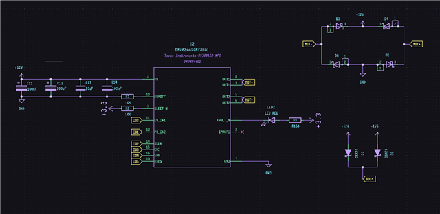

I'm currently working on a project involving the DRV8244-Q1 motor driver, interfacing it with an ESP32 via SPI. I'm having trouble getting the driver to respond to any SPI commands other than 'clear fault' and 'read device ID'. After issuing the 'clear fault' command, I can successfully read the device ID, but any subsequent attempt to write configuration registers or control commands results in the chip not responding as expected.
Here is an overview of the setup and the key issues:
System Overview:
  • Microcontroller: ESP32
  • Motor Driver: DRV8244-Q1
  • SPI Clock Frequency: 1 MHz
  • SPI Settings: MSBFIRST, SPI Mode 1

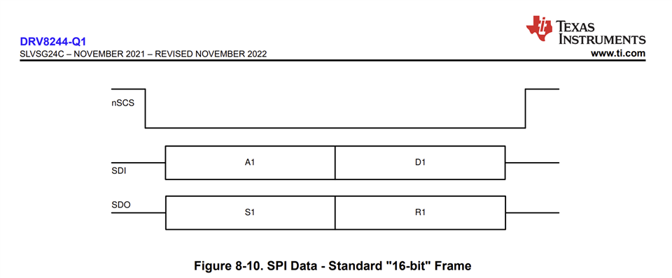

  • Wiring: I have confirmed all connections to be correct, and the nSCS pin is controlled properly during transactions.
No Response to Other Commands: If I attempt to send any other command apart from 'clear fault' and 'read device ID', the chip only responds with 0x0 when reading from FAULT_SUMMARY_REGISTER or STATUS1_REGISTER. This seems to indicate that the chip is either not processing these commands correctly or is locked in an unknown state. 2. DRV8244 Output Control: The chip seems to be unresponsive when attempting to control the motor outputs. I have ensured that the nSLEEP and DRVOFF pins are properly set to enable the active state, but I still cannot get the motor driver to actively respond to control signals.
What I've Tried:
  • SPI Timing Compliance: I have reviewed the SPI timing requirements from the datasheet and made sure my delays for nSCS and clock timing are compliant.
  • Unlocking Registers: I have added explicit commands to unlock the configuration registers before making any changes, as per the datasheet recommendations.
  • Status and Fault Checks: After attempting a configuration write, I read back the FAULT_SUMMARY_REGISTER and always receive 0x0, which indicates no active communication or fault status.
Specific Questions:
  1. SPI Timing: Are there any specific timing nuances that are commonly overlooked when dealing with DRV8244 that could cause the chip to be unresponsive?
  2. Configuration Locking Mechanism: Am I missing a step related to the locking and unlocking mechanism of the configuration registers? I explicitly unlock with the COMMAND_REGISTER but it seems the device still doesn't respond to configuration changes.

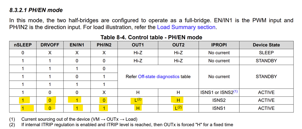

  3. Control Mode Settings: I have attempted to set CONFIG4_REGISTER to 0b00000000 to configure the device for PWM control, but it doesn't seem to enable the output. Could there be an issue with the values I am using to configure the registers for active PWM control?
  4. EN/IN Pins for PWM: According to the datasheet, both EN/IN1 and PH/IN2 must be set high for active operation. I have tried doing this, but the output remains inactive. Is there something else I should be configuring in the registers to properly drive the motor outputs in PWM mode?

  • Hi Matteo,
    Thank you for your post.
    For every SPI register transaction 8-bit address field and 8-bit data field the nSCS must go LOW at the beginning of the transaction and go HIGH at the end of the transaction. For SPI write transaction the values are latched to the registers at the rising edge of the nSCS. This is why it is important for nSCS return to HIGH at the end of every register transaction. nSLEEP must be HIGH for the device to be active and support SPI communication. In the schematic nSLEEP = 3.3 V logic HIGH.
    The power on default state of REG_LOCK bit is unlocked. Though it is redundant to unlock it again it will not affect the device operation. The SPI_IN register is locked by default. This means the device will be configured for pin control for DRVOFF, EN/IN1 and PH/IN2 for bridge control. The DRVOFF has internal pull-up resistor and the EN/!N1, PH/IN2 pins have internal pull-down resistor. DRVOFF is logic LOW in the schematic, so outputs will be enabled.
    The power on default state for S_MODE bits is 2'b00 which is PH/EN mode for bridge control. In this mode the PH/IN2 pin controls the direction of the bridge output and EN/IN1 controls the bridge enable. A PWM input can be used to drive this pin with 0 to 100 % duty cycle for BDC motor speed control.
    The IPROPI pin is left unconnected. The default settings for the S_ITRIP bits in the CONFIG2 register is 0b or current regulation is disabled. So the device should work with no regulation by default.
    In summary without any SPI transactions initiated to the device the device should be able to control the output load with PH/EN bridge control mode when awake and providing proper pin control. IN/EN1 must be logic HIGH and DRVOFF must be logic LOW. The bridge will be driven in one direction when PH/IN2 is LOW and the opposite direction when the PH/IN2 is HIGH.
    If you are still unable to have SPI writes after ensuring the correct nSCS logic please share a logic analyzer or oscilloscope capture of one register write transaction and the following read or write transaction to the same register. Thank you.
    Regards, Murugavel
