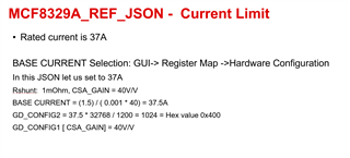

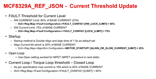

  • Please use this JSON, I have not entered KE which you need to measure from MPET or manual method.
    The reference JSON is tuned for 1mohm shunt, current loop (speed is not controlled).
    Follow the attached document to understand current reference.
    Run MPET to measure KE
    I have entered R, L for per phase and max speed. Please verify once and program if needed.

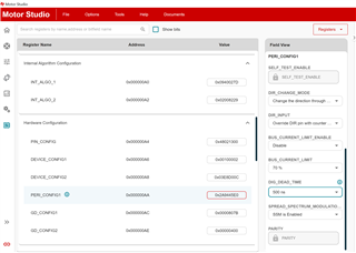

  • Can you show snapshot of PERI_CONFIG? Check if dead time has reduced? It should be 500ns for EVM.
    Thanks and Best Regards
    Venkatadri S
  • Yes, it was reduced to 50nS; I have changed it to 500n; let me rerun it. will post the results.
  • Changing to 500ns has improved the heat issue.
