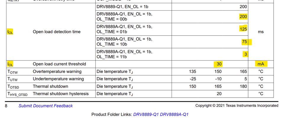

  • I tried to set TRQ_DAC = 100 % and it does detect the OL properly, but it brings another problem: when the voltage of the input VM is low, e.g. 10.5V, the motor triggers the OL during normal motion, and the OL is triggered by the input VM, and the OL is triggered by the input VM, and the OL is triggered by the input VM.
  • Hi Ye,
    Thank you for this update.
    Kindly clarify this comment. If I understood correctly the motor is running normally and OL detection normal when VM = 12 V. While the motor is running if VM is reduced to 10.5 V from 12 V an OL is reported, is this correct? TRQ_DAC = 100 %, VREF = 0.4587 V (IFS = ~ 200 mA). What is the microstep setting used? I think with some microsteps you may be having coil currents < 30 mA current threshold for longer than tOL and would be reporting an OL because of this reason. What was the tOL setting used? You can try increasing tOL setting if you were using a lower setting. Thanks.
    Regards, Murugavel
