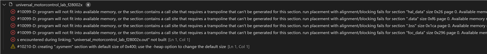

    The UART example I found is sci_ex4_stdout_redirect for the LaunchPad TMS320F280025C, which includes a call to the add_device() function. Each of the three print statements—one to SCIA, one to CCS, and the final one to SCIA—results in a memory error, both when used together and separately. Additionally, I attempted to build a basic list with 20,000 values, which also resulted in a memory failure.

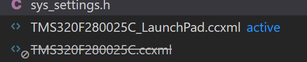

    CCXML:
    Driver select:
    Adding array memory error:
    Even when I try to merge the clean universal_motorcontrol_lab_f28002x project with #include <stdio.h> and add a simple method call puts, I still encounter a memory error.
  • I was eventually able to replicate this behavior with the information from your latest post, thank you for your clarifications and particularly for the build log showing the compilation failure. I'll make 2 posts. In the first post (this one), I'll explain a solution to this issue. In the next post, I'll explain the issue and how I decided on this solution:

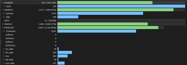

    The error view tells us this information, but the text in the build log stating exactly what memory section failed tells us specifically what we need to look for in the memory allocation. To look at this information graphically, use the "Memory Allocation" view in CCS. This view is populated whenever you build a project to show you the memory allocation. (If the view does not seem to be updating when you re-build, click the "pin" button in the top right and click it again. In my experience, this forces a refresh.)

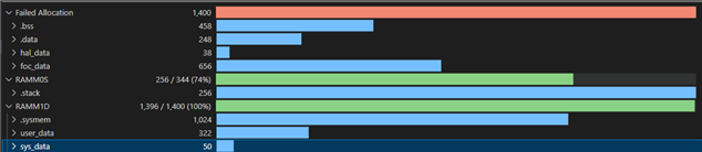

    Here's what failed memory allocation based on the fail state you described looks like:
    Meanwhile, here's what successful memory allocation without any function calls (i.e. before we add any <stdio.h> related functions to the code):
    Note the differences:
    1. .bss (size 458) is only present when the functions are called
    2. .sysmem (size 1024) is only present when the functions are called
    3. .data increases in size from 10 to 248
    All in all, this adds up to a size diff of 1720. Looking at the allocation details of .data, you can see the differences there are related to runtime support for the streaming, as we would expect here.
    Since the RAMM1D (The portion of the MRAM dedicated to data) can only hold up to 1400 and already has 1076 in it before the added functionality, we need to trim it down. The easiest way to do this is re-allocation.
    In the .cmd file I listed, we can see everything that's allocated to RAMM1D. (Just CTRL+F search for RAMM1D and the formatting to look for should become clear starting at the 2nd result.)
    A lot of this can be moved out of MRAM and into LSRAM without facing any issues, in my experience. I chose the sections I did based on my experience with the CMD files of similar projects on this and other devices which allocate differently, as well as how the default CMD file for this device allocates things.
    The new allocation works without issue:
