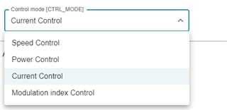

  • Hi Eric,
    Thanks for reaching out.
    The first few frames of I2C data are normal, but after a few frames of data, 8329A will actively pull down the I2C bus What causes this phenomenon (removing 8329A, I2C signal returns to normal)?
    Regarding above query, it is an expected phenomenon. The MCx portfolio of devices have "Clock Streching" which is essentially a feature in the device where the bus is held low for some time (maximum is about 5ms) to enable time for data fetching and processing. Please make sure the primary device (MPS) here, supports clock streching.
    In addition, when we tested 8329AEVM, we found that the phase current ran to around 20A, and the motor could not operate stably. The motor parameters are shown in the attached figure. 8329A configuration parameters are attached. What could be the cause of this?Thank you!
    Regarding your second question, could you please run the motor in Current Control mode and let me know how if the waveform improves? This is to understand if the problem is in current loop or speed loop
    Sachin S
  • Sachin
    The modification to the current control mode still has an abnormality, and the phenomenon is consistent.
    Looks like the current loop is not functioning well.
    There are two control loops in the device - 1. Speed Control 2. Current Control. Speed control always runs current control as current control is an inner loop functioning within the speed loop. So since the current loop is instable, please try to tune out the current loop using the method from the guide attached.

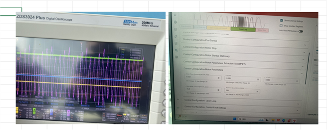

  • Hello, I can also change the sampling blanking time to make the control better, please help to confirm if there are other points that can optimize the sampling related issues. This question is urgent, please help reply, or please tell us how to confirm that there is no problem with current sampling, and if there is any relevant documentation, please give it.
  • Also, I don't do this for the whole rev range, I'm just full speed, which happens when I don't reach the target speed. That's a problem。
    You can also tune the PWM frequency (suggested to set it at 25/30kHz). You can also set the MCC_DEAD_TIME to around 200ns.
    Thanks and regards,
    Sachin S
  • It is effective to reduce the dead time, but in the actual application of products, in order to meet the hardware design risk, the dead time will not be set so small. I can't force it to be so small, is there any other way to optimize this point, and if not, how should I adjust the application of this chip.
  • Hi Zhang,
    Could you also verify if the motor parameters are entered correctly? We need per phase quantities (not phase-to-phase). Also, how are you measuring the resistance of the motor?
    Thanks and regards,
    Sachin S
  • I'm now testing relative to the value of the phases, is this way abnormal? If it's abnormal, how should I measure it and help show the intent.

  • BUS_CURRENT:0x7007aab;CSA_GAIN : 10V/V;     BASE_CURRENT:0X556。    The real power bus uses a current clamp test value of 11A, which is 27 times different from the current value calculated using the above parameter formula.
  • Hi Zhang,
    Could you confirm if the BASE_CURRENT value is correct, I am not getting anywhere close to 11A with the above values.
    What is the calculated value you are getting?
    Also, if the earlier questions are resolved, do you mind starting a new thread? This helps others to find related questions easily.
    Sachin S

  • 1. Now the application of 8329A, the power limit wants to be very accurate, is there a solution, now the minimum spacing of 5% can not meet my requirements, 2, I also want to consult if I want to do the function of the three-phase motor missing one phase, how to make this, how to solve the solution
  • Hi Zhang,
    Do you mean the power limit accuracy requirement is 5%?
    The device has a NO_MTR detection feature, which can be used to detect a missing phase.
    Sachin S
  • I need a current limiting accuracy of 1% of the maximum current.
  • Hi Zhang,
    Sachin is out of office today and will respond to the questions tomorrow.
    Manu
  • Hi Zhang,
    I think we can get an accurate current control and achieve 1% if that is what you are asking. Could you please start a new thread? We have discussed a lot of questions here, it would help others to find and understand similar problems if we create new threads for new discussions.
    Thanks and regards,
    Sachin S
  • Please assist in re-establishing a discussion thread for a question regarding how to achieve 1% accuracy in current limiting, based on the aforementioned motor configuration.
  • Hello Zhang,
    You can click on "Ask a related question" on the top of the page.
    Could you please provide more details on the the 1% accuracy? Are you looking to control the current limit at 1% accuracy (in closed loop current mode)?
    Sachin S
