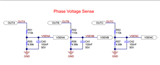

I have one question about DRV8329-Q1.
Customer wants to use FOC by DRV8329-Q1 and we are facing efficiency issues wrt current draw and the current ripple of the supply when compared to a competitor controller board.
Can you please provide the accuracy requirements for phase voltage measuring resistors? And can it be one of the factors affecting the efficiency?
We have changed the current shunt resistor from tolerance 1% to 0.1% as mentioned in one of the posts on this forum.
The operation conditions:
Operating voltage range: 16 V - 32 V
Maximum current draw : 15 A
Speed accuracy requirement: 1%
Reference :
