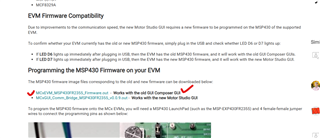

From the Link which you've provided i was able to download the firmware for the 8316A, BTW still not fixed in the download page.

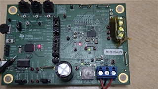

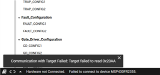

But after flashing this above mentioined firmware on my MCT8318AEVM, I'm getting errors such as Communication with Target Filed: Target Failed to read 0x20AA
Hardware not Connected. Failed to connect to device MSP430FR2355.
The activity light was briefly on.
I'm not able to flash communicate the MCT GUI, WEB or Offiline GUI, nothing works.
Resonse would be much appreciated.
