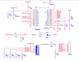

I have made a DRV8955/DRV8923 test board and tried several methods to get the motor running.
The schematic had also been previously provided for E2E review.
e2e.ti.com/.../drv8935-request-for-schematic-review
Unfortunately, the DRV8955 indicated a 'fault' when powered on. The impedance of both VREF pins to ground was only about 300 ohms, although the outputs were not short-circuited.
Could you please help check again if there is any issue in the circuit?
Or, could you provide me with a working reference schematic?

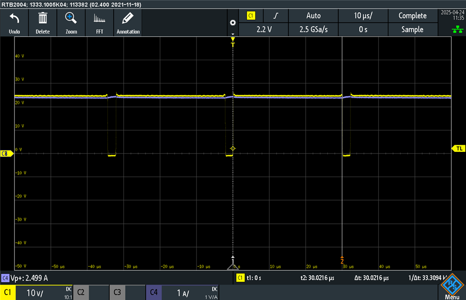

    The fault indication suggests the device may have experienced thermal shutdown. With current chopping DCR 0.3 Ω shouldn't be an issue as long as there is sufficient inductance in the stepper coil. We do not have a 0.3 Ω DCR unipolar to try with an EVM but we have a 0.4 Ω DCR, 3.5 mH bipolar stepper. I connected one coil between an output and VM (high side load) similar to your schematic. See below waveform captures. VM = 24 V, MODE = GND and TOFF = 330 kΩ to GND to replicate the settings in your schematic. Keep in mind while the unipolar common is connected to VM +24 V the IN1 to IN4 must be HIGH for output off and LOW for output on. This means the default inputs from the MCU must be 1 on IN1 to IN4.
    VREF1,2 = 1.9 V, INx = 0, blue is coil current, yellow is OUTx voltage showing tON and tOFF:
    VREF1,2 = 3.3 V, INx = 0, blue is coil current, yellow is OUTx voltage showing tON and tOFF:
    These captures prove current regulation is working with 0.4 Ω DCR stepper coil at the output.
    Also note only slow decay is supported and there is a small tON blanking time before tOFF kicks in for every tON and tOFF current regulation cycle. This means there will always be a minimum tON and minimum ouput current even when VREF1,2 = 0V up to the minimum tON time which may be a couple of μs for this device.
    What is the desired current setting for the coil maximum current? Based on this VM may have to be reduced from 24 V to 12 V because you are using a very low DCR stepper motor. What is the target current required for the stepper and what is coil inductance? Based on this information we can tell whether the DRV8955 would be suitable to drive this motor or not. You can also follow the section 8.2.2.2 Power Dissipation and Thermal Calculation formulae to see if the desired out currents in your application can be supported without a thermal shutdown. Thank you.
