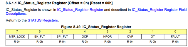

Is there any sample code we ca provide to customer? where I can find the GUI, the MCT8316Z can't be found in motor studio.

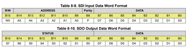

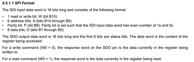

Could you help give me an example for read IC_status register? How should the SPI master send the command? give us a SDI/SDO example.
