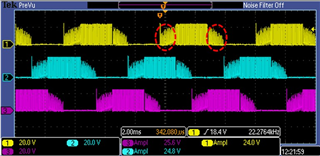

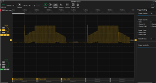

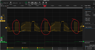

I'm currently working on a BLDC motor control project using the DRV8306. The motor has hall sensors for feedback.
However, I'm facing some issues:
The output waveform is distorted; it's not a clean trapezoidal shape.
The motor heats up after a short time of operation and emits a noticeable high-pitched whine.
I'm suspecting there might be a misconfiguration in either hardware or software.
I'll be attaching the following for your reference:
Code that handles the hall sensor reading and commutation logic
Schematic of the custom board connected to the DRV8306
- Osciloscope images of the output phases and hall sensor readings.
I have tried a different motor with the same specs, and the noise goes away on a proprietary board that came with the motor. On both the only signals I'm providing from the MCU is the PWM and Enable signal.
Unfortunately I only have a two-channel osciloscope, so I couldn't see all the hall sensors and phases on the same image. It would be highly appreciated if someone could enlighten me on some possible causes. Thanks in advance for your help!

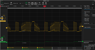

Phase A and hall A:

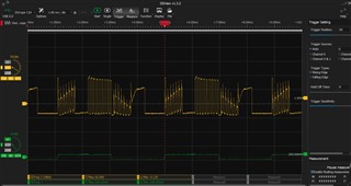

Phase B and hall B:

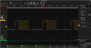

Phase C and hall C

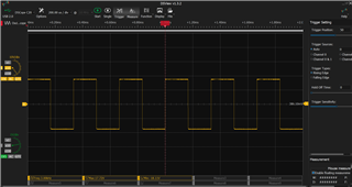

PWM Wave sent to the DRV:
