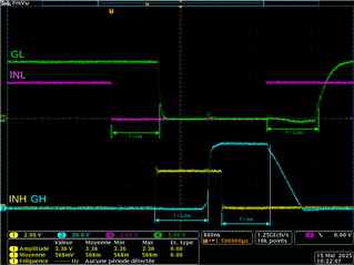

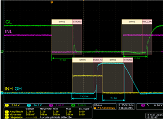

On the initial configuration, the register GD_CTRL2 is set at : GD_CTRL2 [1F] = 0x0717
P N
TDRIVE 1.036us 1.036us

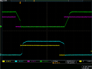

The resulting waveform are bellow, with the signals INL/GL and INH/GH displayed. Probes are placed on testpoints GLA, GHA and J9 connectors pins 1 (INHA) and 3 (INLA).
We can observe an huge propagation-delay/deadtime of ~1us between the moment the input signal switch state and the gate driver output follows command.

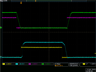

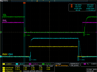

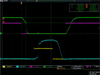

Then I test with a new configuration of GD_CTRL2 [1F] = 0x0010
P N
TDRIVE 0.143us 0.143us
Now you can see that output follows input way better. What you could assume is that this delay is directly selected TDRIVE as the measured delay matches the settings in GD_CTRL2.

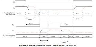

But according to the datasheet, TDRIVE is the time the IDRIVE current is applied. I don’t see why it would add a delay BEFORE driving the gates.

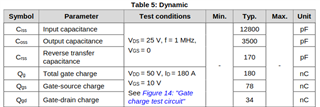

Bellow is the Figure 6-6 from datasheet. I added in red what I think I observe.
So why does it behavior like this ? I saw many explanations of TDrive on different Smart Gate Drive IC references and none of them match this behavior.
We are building a robotic BLDC driver and are planning to use the DRV8334 but so far this reference is not easy to handle as the datasheet isn't very detailed on configuration steps.
My final design will use CSD19502Q5BT mosfets. I’m planning to have ~100ns switching time for my mosfet to match EMI performances. Can you help me with what settings should I use for IDRIVE/TDRIVE/DEADT combination ? The PWM frequency will be around 50kHz to 100kHz so I can't afford >1us delays like in the first picture.
