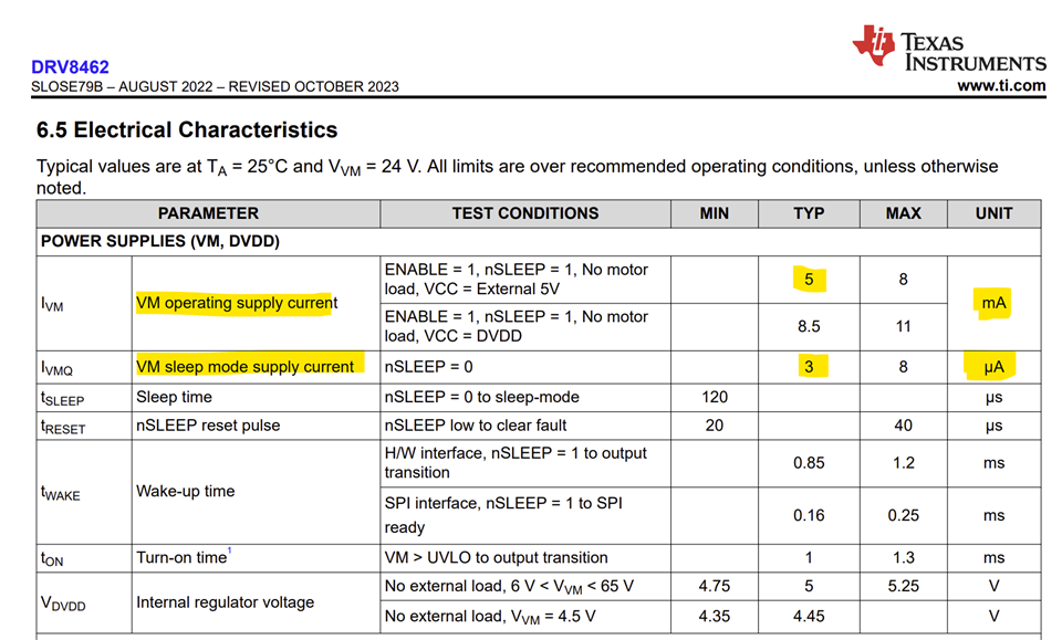

    A good way to cross check driver circuit would be to measure the below two currents and check for compliance. This would be with no load connected.
    Assuming these check out we can proceed with the following debug. Let's focus with U13 first - keep U14 in sleep mode. Connect just the coil A to U13. Let's retain all the registers in default configurations except changing EN_OUT = 1b in the CTRL1 register to enable to outputs. The indexer will point to Home position electrical angle 45 °. Both coils would have 71 % of the IFS set by VREF here 1.44 A, so 71 % would be 1 A. A current probe on coil A should measure 1 A. Likewise for coil B, the current probe for coil B should also measure 1 A. Could you please check these and if possible capture coil A and coil B current waveforms?
    Also would be useful to check the nFAULT pin voltage, if no faults it should measure the DVDD voltage level 5 V. Because the indexer will be in Home position nHOME pin would be 0 V. If nFAULT = 0 V please read FAULT and DIAG1,2 and 3 registers and share with us. Thank you.
