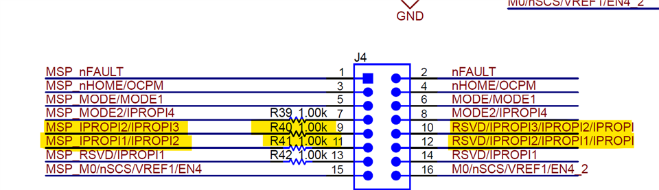

    Which pin on the EVM board is this exactly?
    The EVM has two 3.3 kΩ RIPROPI resistors in parallel (1.65 kΩ) after J19 shunt is installed for Single H-bridge operation. See below. With external VREF = 3.3 V (VREF MAX) the current through IPROPI would be 3.3 / 1650 = 2 mA. The specified AIPROPI for this device is 212 μA / A. The output current would be regulated at 2E-3 / 212E-6 = 9.4 A

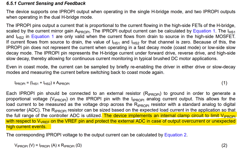

    3. Current measurement – ​​IPROPI
    I want to read the current consumption of the coil via the IPROPI pin and measure it with an STM32 .
    According to the datasheet, in single H-Bridge mode there are two IPROPI pins that should be connected together .

    The IPROPI is connected to the MSP430 ADC inputs via an RC LPF 1 kΩ  and 0.1 μF. You can have an RC LPF that suits your requirements.
    Do I need a voltage divider, or is the signal already adjusted?
    The IPROPIx has internal clamp to limit the voltage on this pin to VREF voltage. VREF range is 0.05 V to 3.3 V. With MAX 3.3 V the input to an ADC will be clamped to 3.3 V. Generally a voltage divider may not be required. This would depend on the ADC input voltage range. The onboard MSP430 ADC input range is 0 to 3.3 V.
    Do I need to install an external shunt resistor, or is it integrated into the board or IC?
    Current sensing is integrated in the device. No external shunt resistors are required.
    See below image snippet for EVM configuration.
