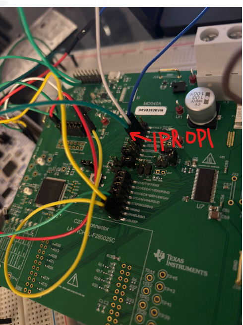

I'm using the DRV8262 in single H-bridge mode, and I'm trying to use it together with an STM32 to measure the coil current via the IPROPI output.
According to the datasheet, IPROPI1 and IPROPI2 should be connected in this mode – so I’ve made some changes to the solder jumpers and bridges on the board accordingly.
I’ve also manually set VREF to 1.65 V using a voltage divider, and I'm reading the IPROPI signal via an ADC on the STM32.
Wrench My current setup:
  • I’m controlling the H-bridge from my STM32 via IN1/IN2
  • VREF is manually supplied with 1.65 V via a voltage divider
  • I’m currently only reading one IPROPI pin via ADC (the other is not connected)
  • I’ve modified some solder jumpers (opened/closed) to try to configure this setup
  • I've attached a photo showing all current jumper/solder bridge configurations

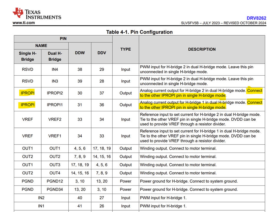

  2. Do I really need to connect IPROPI1 and IPROPI2 together in single H-bridge mode?
  3. If yes, which ones are the correct physical pins on the board that correspond to IPROPI1 and IPROPI2?
  4. Can someone please take a look at the attached image and confirm if the jumpers look correctly set for this configuration?

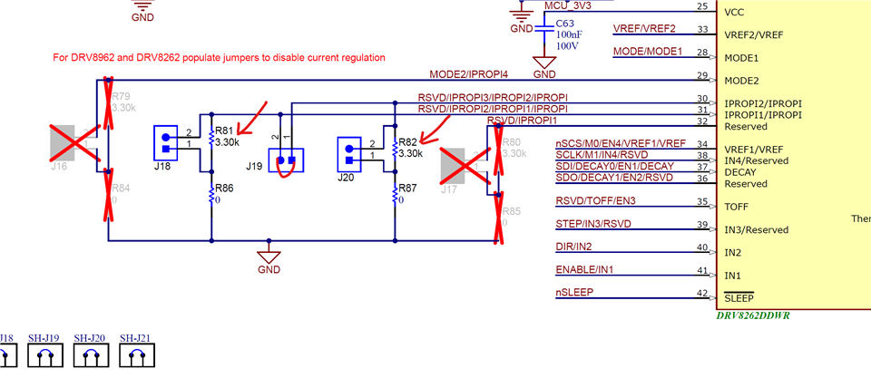

    Yes this is required in single H-bridge mode. See pin out description. They're not internally connected in this mode hence this is required. If not tied together only about 1/2 the current (from one bridge) will be reflected in the RIPROPI voltage.
    Bridging J19 would make this connection on the EVM.
    I've provided this information in the referenced post towards the end. I'll reproduce the image for convenience. The jumper shorts with a red X mark must be unpopulated and jumper shorts of the headers that need to be populated are shown, J25 and J19. External VREF must be provided only to pin-1 of J7 - has no jumper short.
    In the image shared by you they all seem to be agreement although with the angle of the image I cannot say for sure. One thing I noticed was the two jumpers connecting IPROPI to the onboard MCU ADC were still populated - see below. The ADC inputs of the onboard MCU may load these pins better to remove these two jumpers. Likewise you can remove the nFAULT and the OCPM jumper shorts as well to isolate it from the onboard MCU.

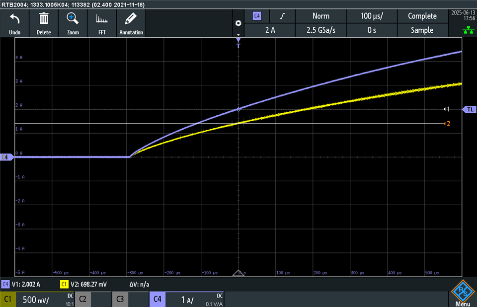

    With the suggested connections I tried the EVM in Single-H mode with a BDC motor. See below scope capture, motor driven with 35 % duty cycle. Blue trace C4 is the motor current and the yellow trace C1 is the IPROPI voltage. The cursor on C4 reads V1 = 2.2852 A and the IPROPI voltage V2 = 800.81 mV. RIPROPI is 1.65 kΩ (J19 populated). The IPROPI current would be V2 / 1650 = 800.81E-3 / 1650 =  4.85E-4. Using 212 μA / A, the AIPROPI value the calculated current is 4.85E-4/212E-6 = 2.288 A which is in agreement with V1 readout 22852 A. I tested with other load currents as well and found expected readout.
    Now, here's a tricky point to keep in mind and this is due to the EVM circuit behavior. Observation: When J19 is removed the measured voltage on each IPROPI pin is same. This is expected behavior because when the J19 short is removed each IPROPI pin will have 3.3 kΩ RIPROPI on them. So even if the current is 1/2 of the total value x2 is provided by the change from 1.65 kΩ to 3.3 kΩ! This is proof that each IPROPI output is 1/2 of the total current, the current flowing via each of the two parallel H-bridges.

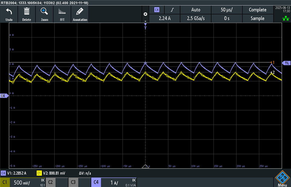

    See below capture with VM = 5.2 A CV power source, Trigger for load current set at 2 A. The load is a BDC motor so it has an inrush current of several amps. The cursor on the load current at trigger point V1 reads 2 A. The corresponding IPROPI voltage reads V2 = 698.27 mV. With 2 A the IPROPI current should be 2 x 212E-6 = 424E-6 A, the voltage would be 424E-6 x 1650 = 699.6 mV which closely aligns with V2 = 698.27 mV. VREF was set to 3.3 V for the above two tests. Now, if I set VREF voltage to 699 mV the load current would be regulated at 2 A which means the inrush current would not exceed 2 A. See the second capture with VREF = 0.699 V.
    Note: I'd not rely on the current shown by the power supply. Instead, measure the actual load current. Especially while running with current regulation

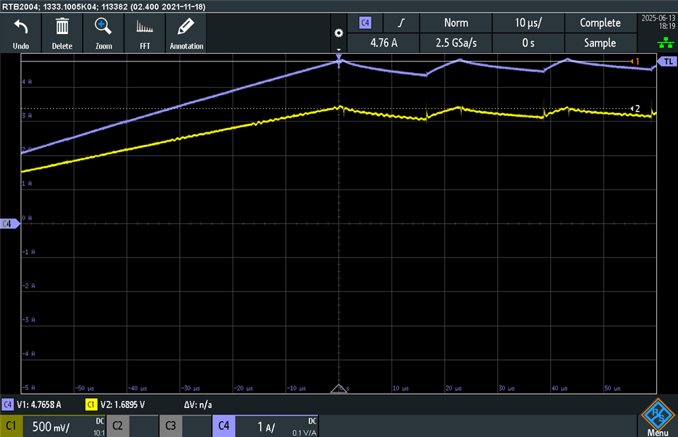

    There are no known issues that'd impact IPROPI output in Single-H configuration PH/EN mode. See below capture with VREF = 1.65 V input from an external source to the suggested J7 header pin. With VREF = 1.65 V the inrush is expected to chop at around 4.72 A and not exceed this value. To help achieve the motor exceed this level of inrush current I increased VM to 24 V and control to 100 % duty cycle.
    VIPROPI should read close to 1.65 V. Cursor V1 reads 4.76 A and V2 reads 1.69 V pretty close to the expectation, albeit, minor errors likely contributed by the ITRIP circuit offset voltages.
