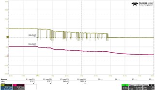

    Below waveform was short-circuit test on U-V or U-W phases of the DRV8350. When performing short-circuit, the nFAULT pin is high -> Low -> high ->  Low..., not very stable. The question is that how the behavior is with 1uF filter? Why 1nF doesn't?
    Customer suspected if the external capacitor has relationship with nFAULT pin or not? Could you help on this clarification in advance! Very Thanks.
    Scope setting:
    CH1: nFAULT pin of the DRV8350, CH2: GD_FAULT_C (Conneted to MCU I/O pin)
    Pull-High Resistor (Rpu) is 10Kohm(default)
    We have tried Rpu that was changed from 10K-OHm to 1K-OHM, but there is no improvement.
    Filter C: 1uF
    Brian
  • Hi Brian,
    Yes I suspect the capacitor is causing the behavior the customer sees in the waveform.
    1nF: OK -- Smaller cap value allows nFAULT to be pulled down in shorter time when fault is detected. Correct behavior.
    1uF: NG -- Bigger cap value is harder for device to pull down in time, holds charge from Rpu, which causes bouncing (high, low, high, low..) effect.

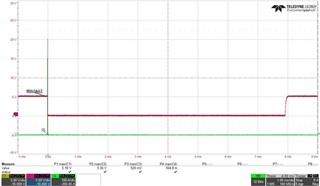

    For the bouncing behavior with 1uF, customer still don't understand very details. Here're two configuration of the R/C filter in the below slide. and you can see the different behavior of the nFAULT signal. Could you help to clarify this behavior more! very thanks.
    DRV8350 Issue July16, DELTA.pptx
  • Hi Brian,
    1. Can DELTA also provide waveforms of the supply of the pull up (5V) to see if the supply is dipping during the testing?
    2. Can they try more values less than 1uF? (Try 47nF, 100nF, 500nF . . .)
    Please note that it is not recommended to put such large capacitors on nFAULT pin, this is why customer sees incorrect behavior.

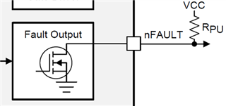

    The device's internal pull down structure is not designed to have any extra current sink through the nFAULT pin other than the small amount of current from the 10k pull up resistor.
    There is no way around this, and hence why you see this behavior with the 1uF capacitor.
    The recommended ESD protection is to use a TVS diode with a breakdown region above operating voltage, but low enough that it allows for a path to ground during an ESD strike. I have tested this method as a successful way to protect our devices from ESD.
    Please understand that the device's internals are NOT compatible with a large capacitor on the nFault pin. The large sink current and therefore large amounts of ringing on internal pulldown structures caused by the cap is most definitely the source of the bouncing.
